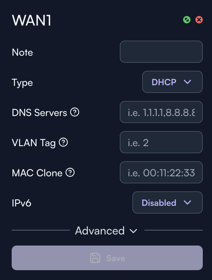

In my case it’ll likely be the second scenario, not having a concurrent connection with the two ISPs. I’ve managed to locate the WANs section in the cloud controller. It appears my current ISP connection is via DHCP which doesn’t seem to require a username and password? Does this mean if my next ISP also uses DHCP I should be ok with not changing anything and it’ll automatically switch over?
I think in the past I have had ISPs who have given me PPPoE username and passwords which I’ve had to enter manually. I presume I’ll have to use reset method if that is the case this time around.
