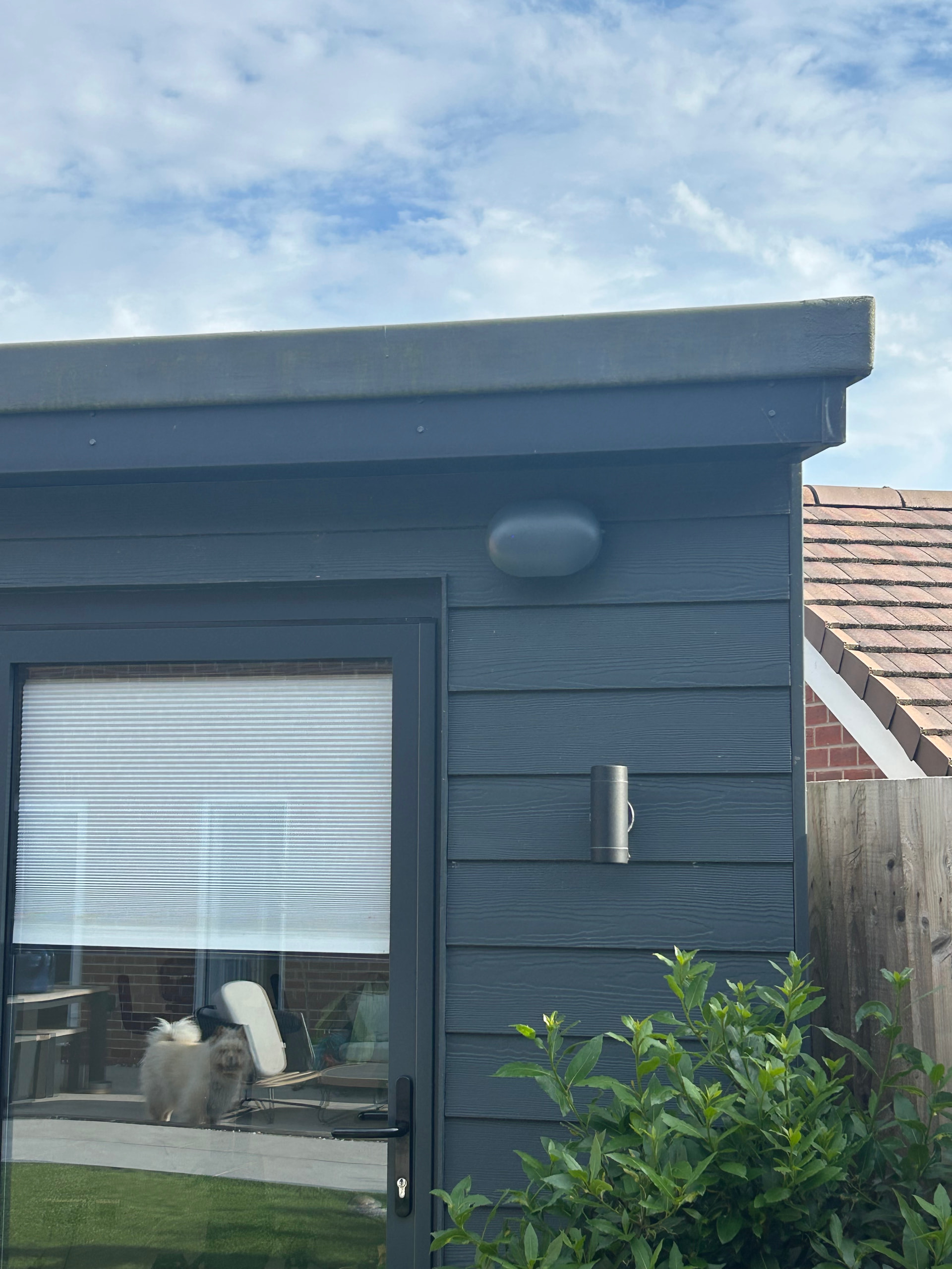

I painted one of my AP6’s black - it looked good and worked perfectly. I should have sprayed it for a smoother finish but I did have a pot of black paint that I used on my UPVC front door.
If you don’t look too closely you don’t see the brush marks! lol.
It was only for my kitchen so it didn’t matter if it lost a bit of signal but I didn’t notice any difference. It also didn’t seem to make any noticable difference to the temp of the AP.
After reading about people painting their APs on here, I thought I’d give it a go with my outdoor AP. It definitely looks better than a big white bean stuck on the front of the building. No reduction in speed, and I only painted the top cover, so it shouldn’t affect airflow or anything. Thanks for the idea and advice!
