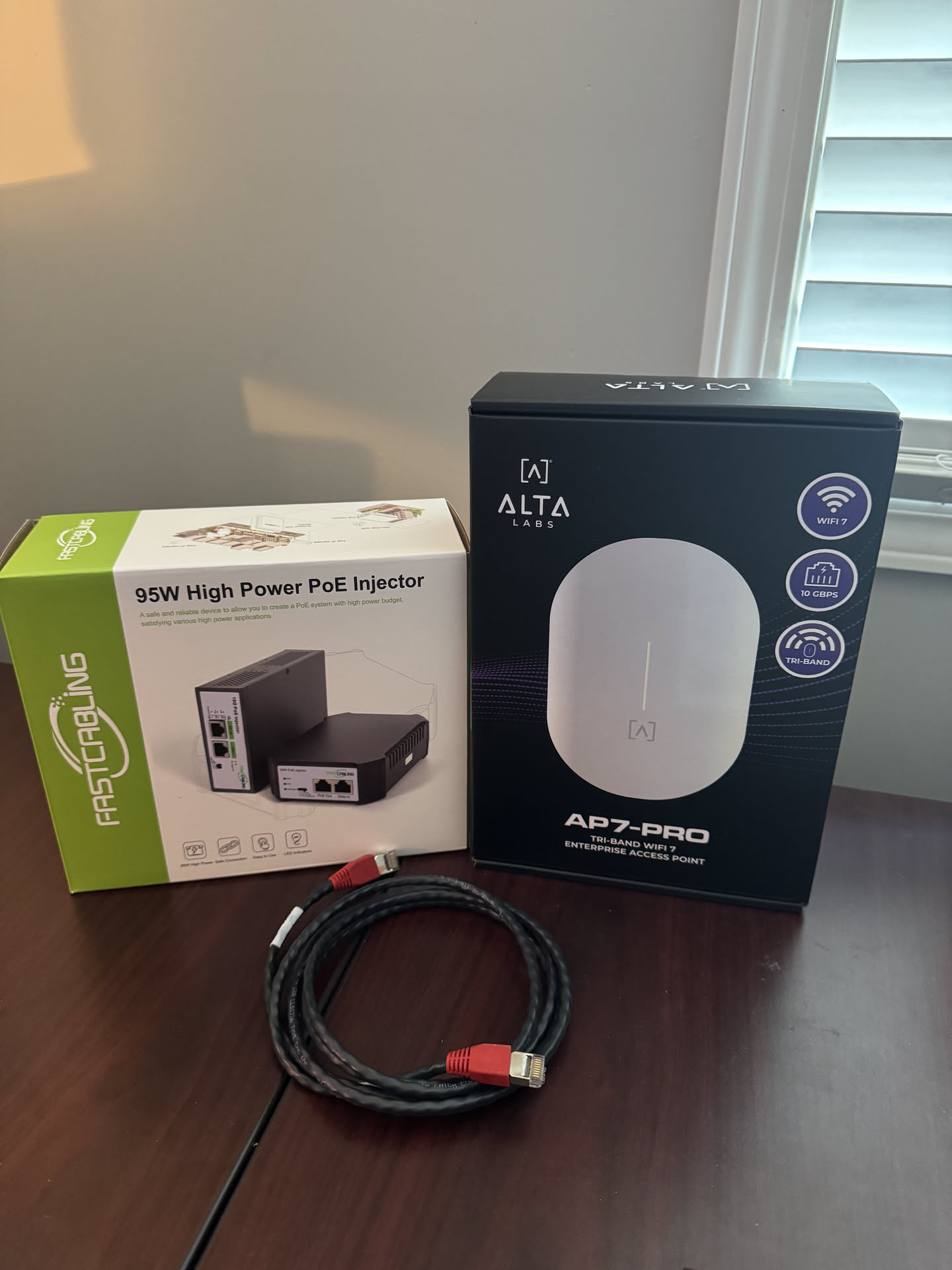

Did any of us beta tester / Content Creators get their AP7-Pro ap’s this weekend ?
Any of you got some testing done ?
I’ve got some ideas to be testing I’ll be starting with 1gig POE then 2.5G poe & finally 10g poe through put testing using iperf & Locally hosted LibreSpeed on a dedicated vm with 10g link.
I’ll also be showing some wifi data using the Netally Aircheck G3
