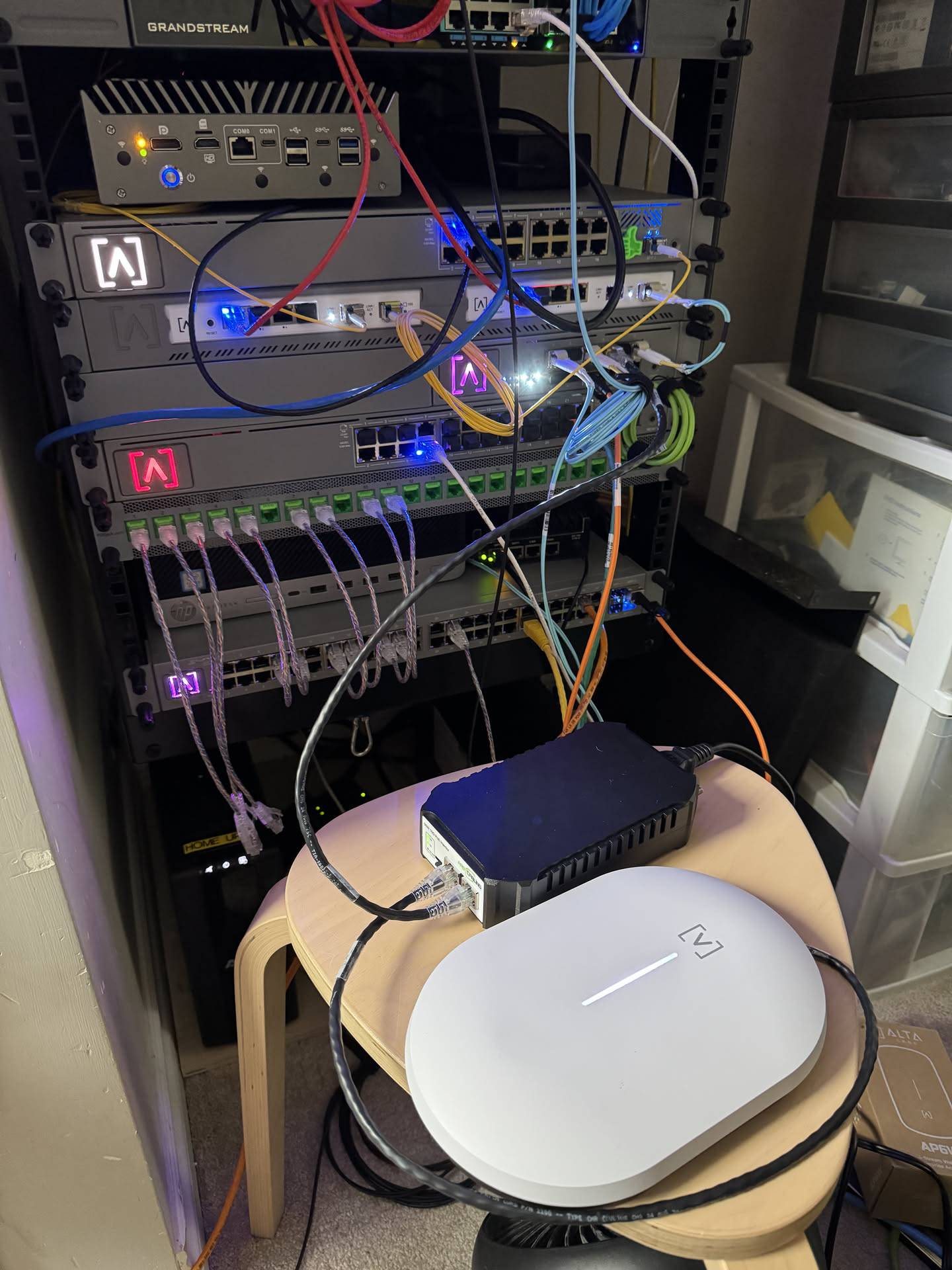

Port 7 on S12 > SFP+RJ45 > POE++ 10gig Injector > 8’ or longer cable > Ap. ( flaps )
Port 7 on S12 > SFP+RJ45 > POE++ 10gig Injector > 1’ cable Ap. ( no flaps )

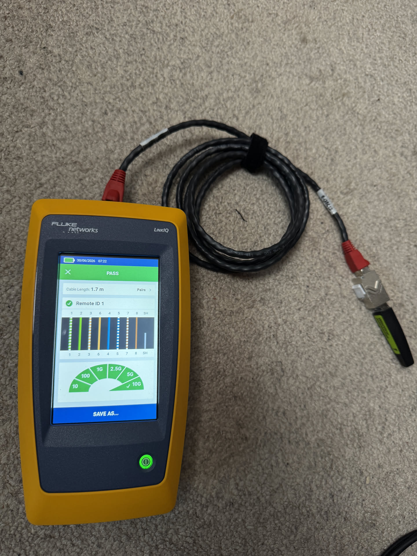

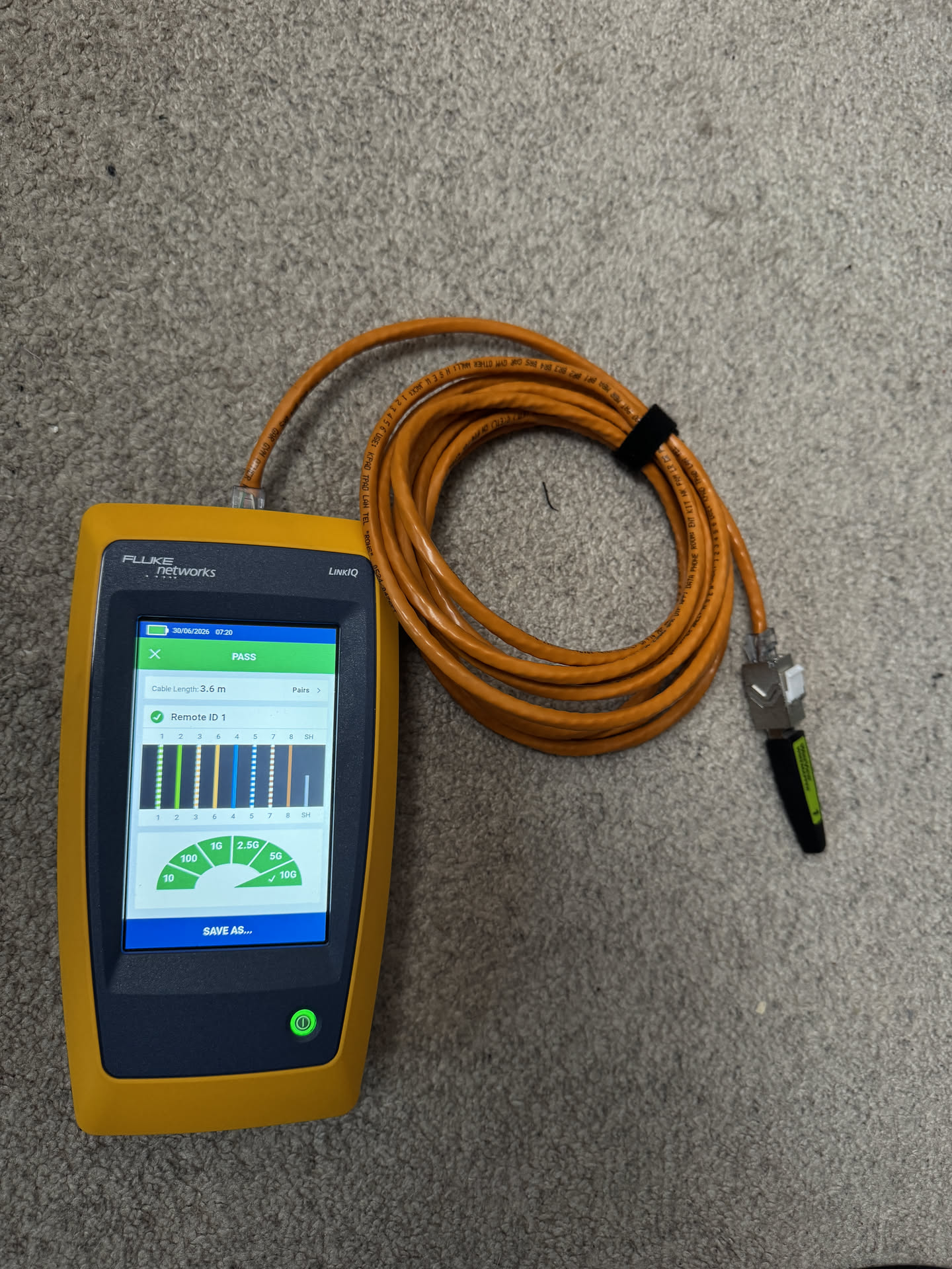

ALL cables pass to the 10gig mark on the FLuke LinkIQ

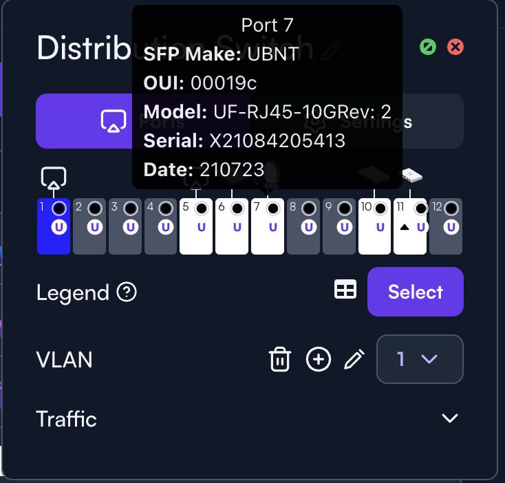

Please give us the make and model of the injector and the RJ45 SFP+ transceiver. We have not been able to reproduce the flapping nor the requirement to force to 10G in our testing.
Here you go Jeff,

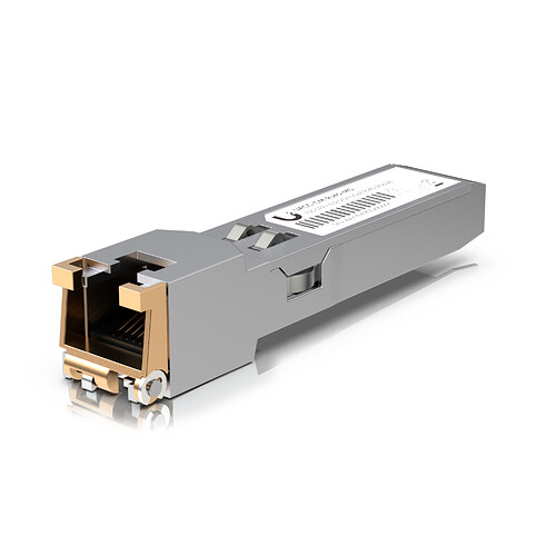

Reporting back, I changed the SFP=-RJ45 transceiver for a generic one off amazon, go figure it works better then the Unifi one.
Will report back of any issues in the next few days, so far going on 24 solid hours no issues.
Link to working unit : 10GBASE-T SFP+ Transceiver, 1.25/2.5/5/10G SFP+ to RJ45, 10Gb Copper SFP+ to Ethernet Module for Cisco SFP-10G-T-S, Ubiquiti UniFi UF-RJ45-10G, Mikrotik, Meraki, Netgear, D-Link and More, 1 Pack : Amazon.ca: Electronics
