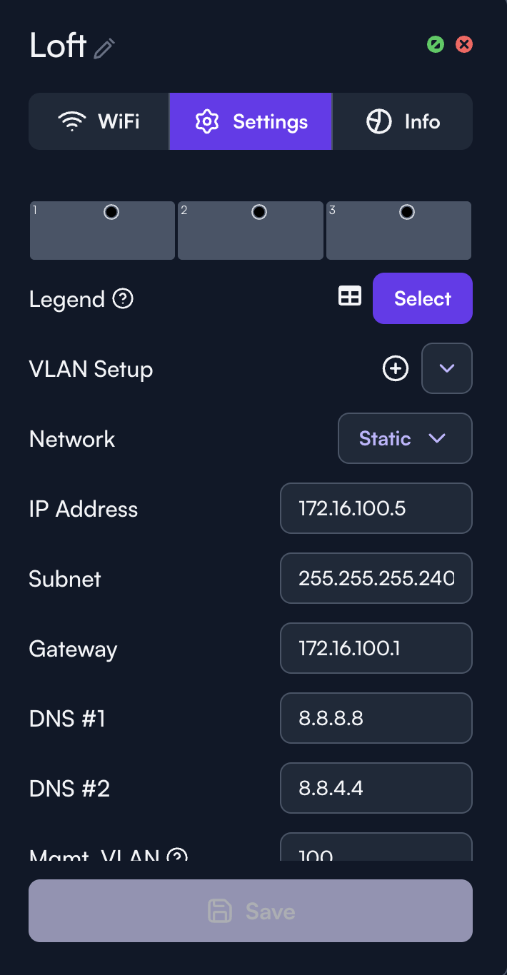

When setting up my AP6W, I’m able to statically assign a management IP address while it’s connected to an access port assigned to VLAN 100. However, after changing the management VLAN from 1 to 100 and connecting the device to its trunk port, I lose connectivity to the access point, and its MAC address is no longer present on the switch interface.

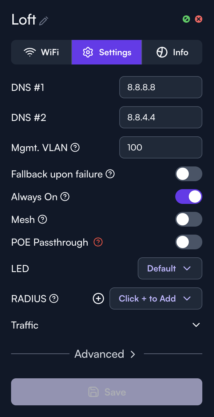

I am using this exact config with my AP6 Pros and AP6 outdoor without any problems. Just to confirm, did you turn off the “fallback upon failure” option for that AP?
I did. I configured the entire access point and switched over to VLAN 100 as the final configuration change. The only option I have enabled in that area is “always on”. Same setup method was used on my other Alta access points with no issues.
Everything looks proper in those screenshots. Maybe there’s something specific about the AP6W. What is that VLAN setup option for? Unfortunately I don’t have an AP6W to test with, hopefully someone else can chime in.
I wonder if this bug that I reported last year which was fixed in 2.2n has regressed. I’ll test it again this morning with “Fallback upon failure” left enabled. I’m not sure I understand your question regarding VLAN setup option.
Leaving “Fallback upon failure” enabled did not make a difference.

Anthony was unable to replicate the issue and suggested I take a screen capture of me performing the steps that cause the issue. After doing so, Anthony came back and identified that there were no VLANs present under Settings → Networks → VLANs.
I’ve never had VLANs configured in the controller because my two AP6-PRO access points work fine without them. That’s where Anthony took the time to explain why they’re needed for the AP6W. The AP6W is essentially a wireless access point with a built in switch, which is why the VLANs need to be configured. Without the VLANs configured, Anthony was able to replicate my issue nearly instantly.
After configuring the VLANs, my issue went away, and the AP6W started acting normally.
