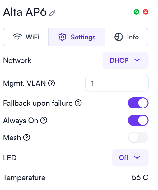

That’s why mine is desk mounted and with USB powered fan blowing directly, operating at 55~57C
So, one conclusion from that is that 58-60 deg C, in question, is extremely low, almost as low as that baseline of @dxyong’s at 55-57 deg C with active cooling. :grinning_face:
It also depends on your ambient temp, mine is 30C all year round :joy:

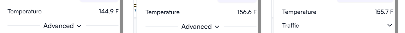

  1. The APPRO1 on the left “temporarily for testing purposes” has been pitched at 45 degrees on a table in my home office.
  2. The APPRO2 in the center is mounted directly to the ceiling, about a foot away from an HVAC supply air grill with the provided mounting kit.
  3. The AP6W on the right is mounted directly to the wall in the kitchen where a traditional POTS jack/box would be, except I have cat6 to that location.
Clearly you can see there is a huge temperature difference from one being open to air versus the others being sandwiched on a ceiling or wall.
IMO, you’ll be fine if you have an HVAC, portable AC system or any sort of filtration system that constantly or intermittently pulls and circulates air in the room they’d be located in.
Steer away from installing in places like closets that have minimal circulation.
I have one that will be going into the garage at some point where temps can reach 105-110 during peak summer periods. That will be the true test.

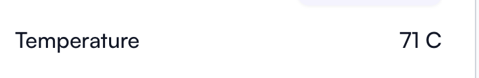

Mine always runs about 70C, its been like this for over a year, no problems so far.
