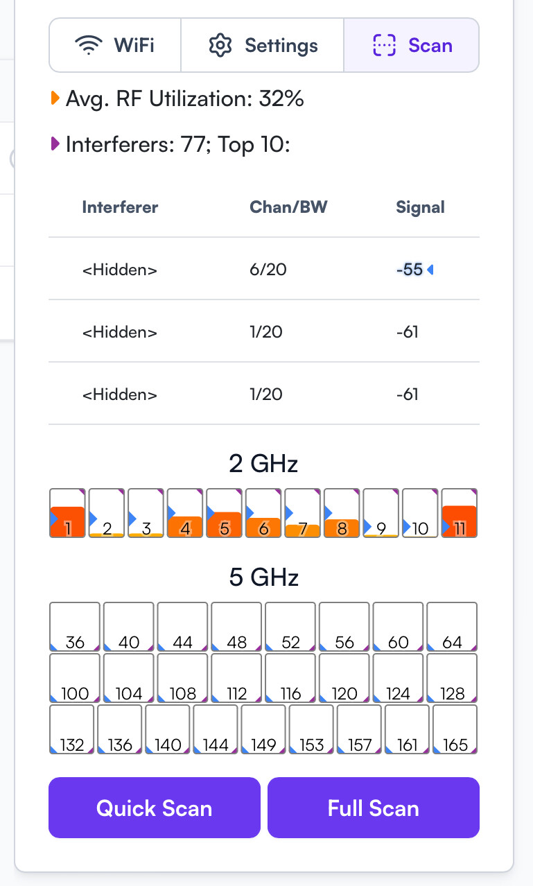

Hi @Alta-Matt_v2 ! Thank you for the quick response. I have attached the results of the full scan here. The last few days, the issue has presented itself first thing in the mornings when I sign on to start work however I have also seen this at other times though. I typically don’t ever see this more than once per day though which adds to the oddity of this.

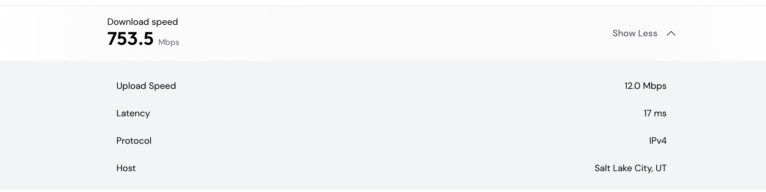

Also, just for reference, here is a screenshot of a speed test (Comcast Xfinity) during the issue and after I reboot the AP:
Interesting to see that the upload doesn’t seem to be proportionally affected.
I’m going to send you a DM to invite me to your site, the scanning didn’t quite yield what I was looking for.
