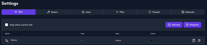

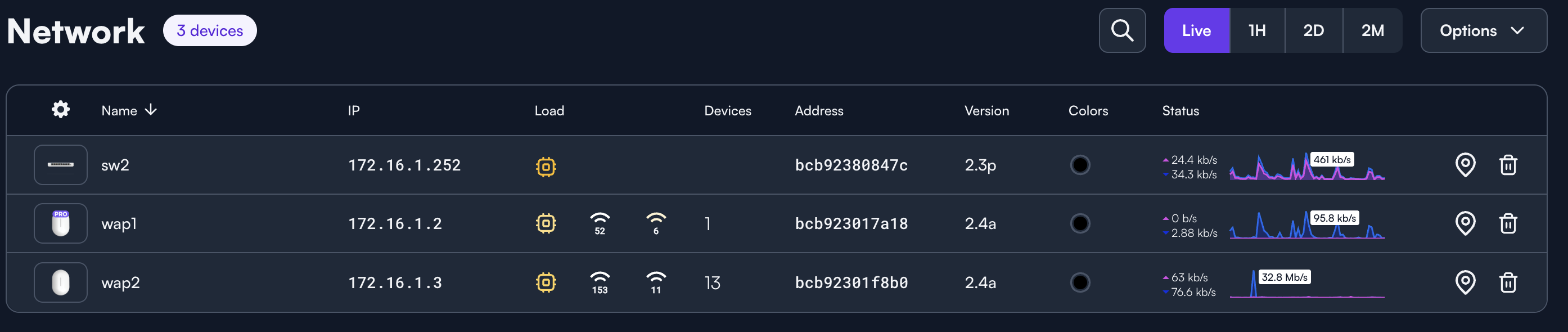

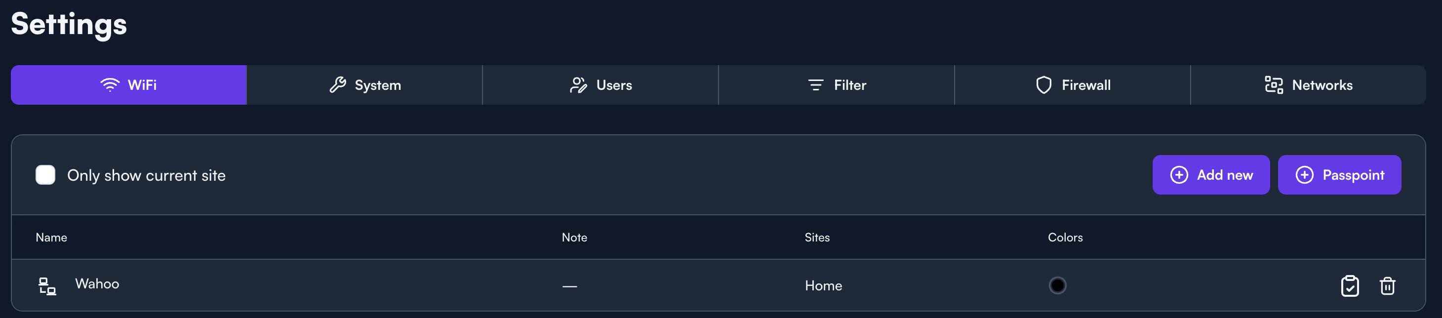

  1. Your SSID’s and your AP’s colors do not match up. You can watch https://www.youtube.com/watch?v=uZBzZWr5iEY for guidance on this.

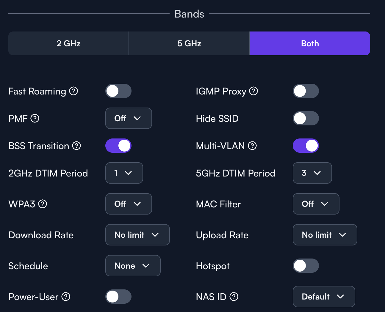

  2. Your 5 GHz radio is disabled on your AP (click on the AP’s name in the Network page, then look at the channel by 5 GHz.
  3. You have the band set to 2 GHz only on the SSID (Settings→WiFi→Your SSID→Advanced Settings)
Hi, as requested:
  1. my switch, both access points, and wifi SSID’s are all using the default black… Screen shots attached.
  2. 5Ghz radios are set to auto/auto and wap1 is on 5Ghz channel 52 as can be seen in the attached screen shot.
  3. It’s set to both as can be seen in the attached screen shot.
Any other ideas or info I can provide?
