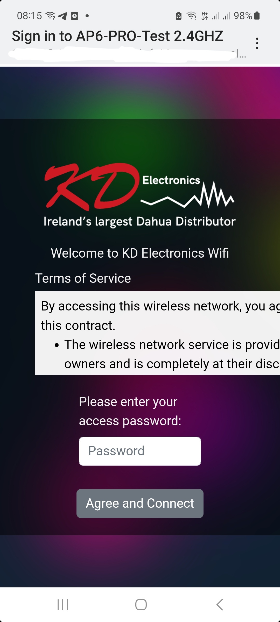

We set up the main WiFi network SSID and allowed it to bypass the hotspot. Then set up a second password for guest network connecting that will land on hotspots landing page for our customers visting.
Before on previous setups, there has been mulitple guest SSIDs broadcasting from the same radio. Having the one SSID and different passwords for user groups is so much simpler and easier to manage and will cause less SSID rf interference. Limiting bandwidth then to that guest network but still only broadcasting one SSID and just a different password is brilliant.
One note would be to wrap the terms and conditions text for mobiles devices connecting to the hotspot.
Thanks Ian! I’ll note this UI issue. Should be fairly simple to fix this one.
Keep them coming! :slight_smile:
I see this has been rectified already. Vey fast turn around time :ok_hand:

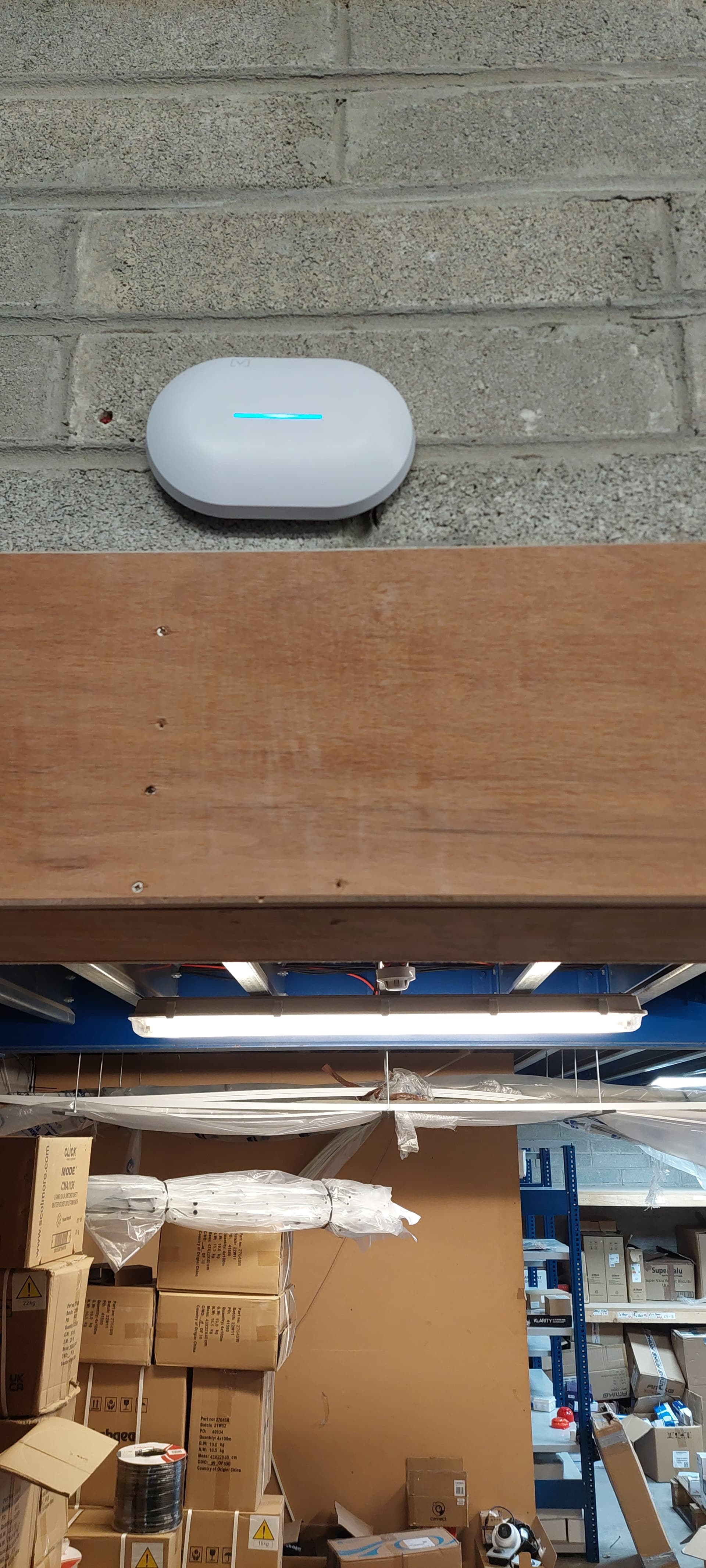

After weeks of testing on the desk, we decided to wall mount in a temporary test location and the one AP6-PRO is giving sufficient coverage now to our whole warehouse.
Previously we needed 2 to 3 Aps for the same coverage.

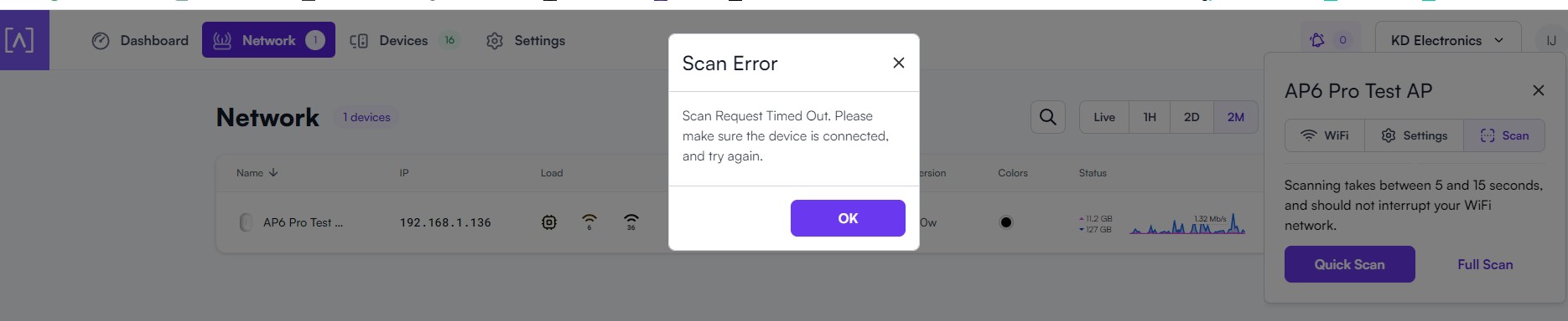

Hi Lads,
Is there any option to reboot an AP or maybe Im blind and can’t see it.
Only reason was rf scan function is showing an error the last 2 days, thought a simple reboot remotely might solve it and I don’t have access to our switch right now.
All other AP functions working perfect.
Nevermind logged out and back working fine again.
There is the opportunity for rebooting via SSH currently, or another option could be to change the channel and change it back, so it re-applies settings and see what happens?
