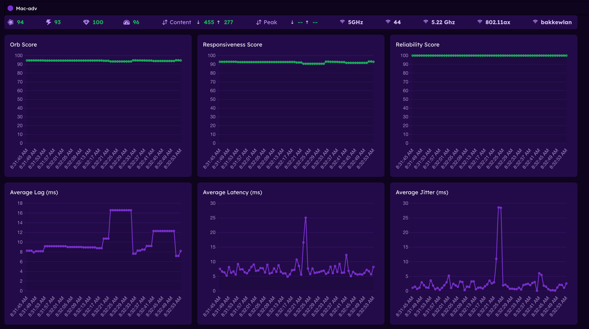

Since you asked if anyone else was seeing issues like yours @eba , I figured I could at least toss some data in. I’m not seeing an frequent latency spikes as far as I can tell, just to cut to the chase on that, but hopefully this can help in some way :slight_smile:

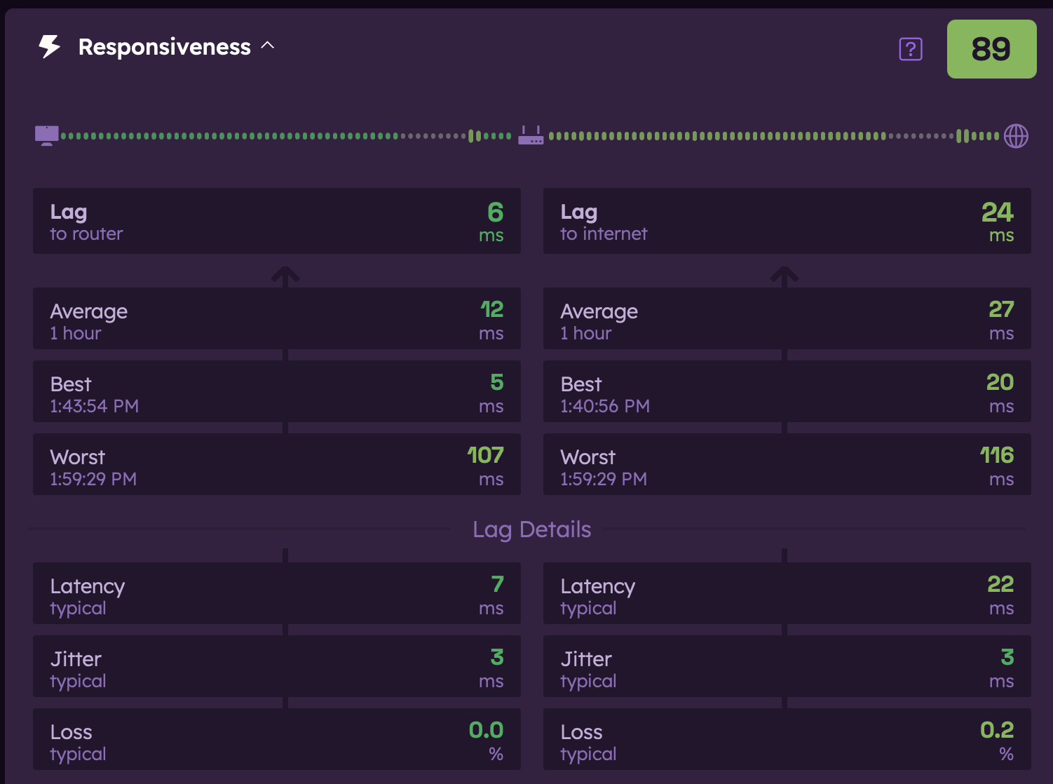

I have a couple of AP6’ running in my environment along with Orb running on an M1 MacBook, so here’s a quick snapshot of some statistics Orb recorded over an hour:

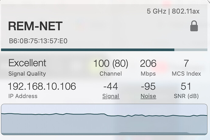

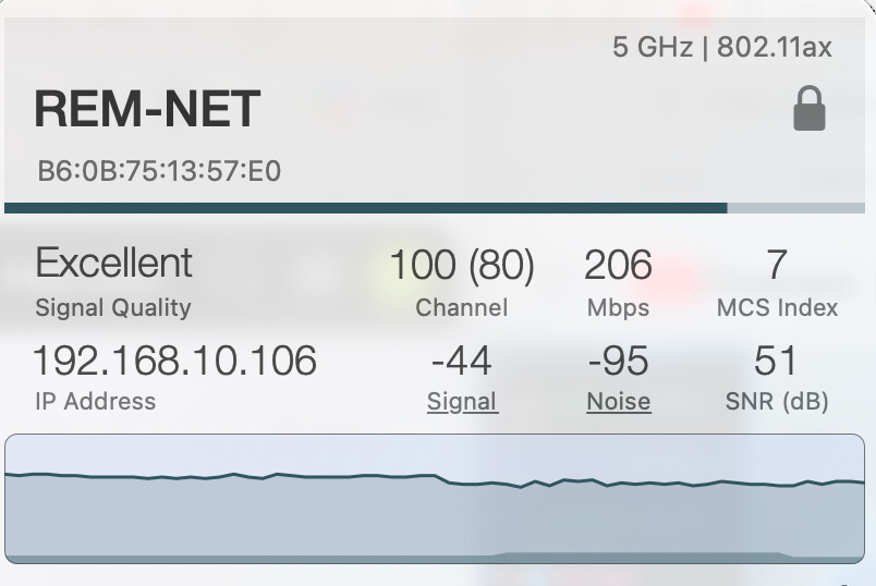

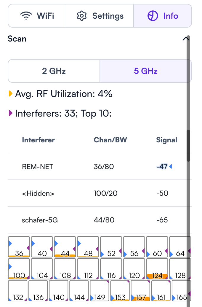

The RF environment the AP the MacBook is connected to showed on the 5GHz band

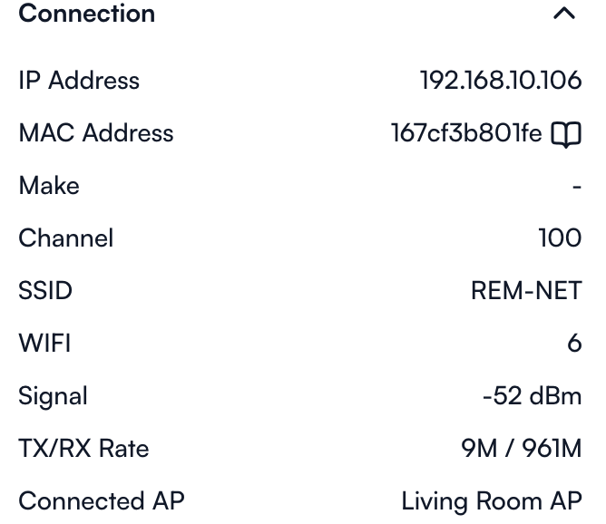

Connection info of the MacBook the controller was showing
and then some connection info recorded using the app WiFi Signal on the MacBook

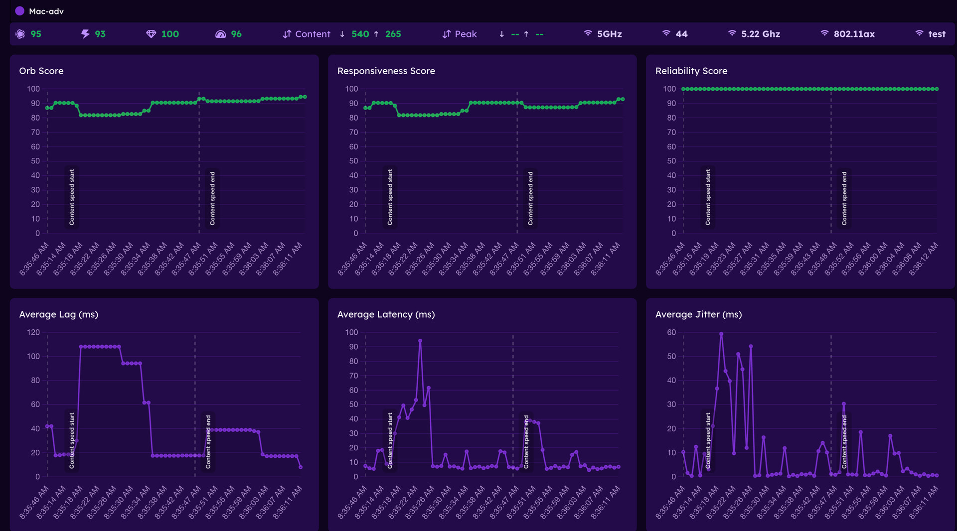

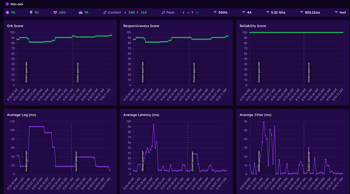

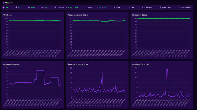

Here is ORB on my mac M4 connected to meraki MR36 with 20 clients connected:
Here is ORB with just my mac M4 connected to a test SSID and all MR36 disconnected:
I also get some packet loss ping default gateway (router 10), no loss with same client connected to meraki AP with alot more clients connected.
the “spike” you can see in average lag is what i “feel” and is randomly “all-the-time” on 2 sites.
