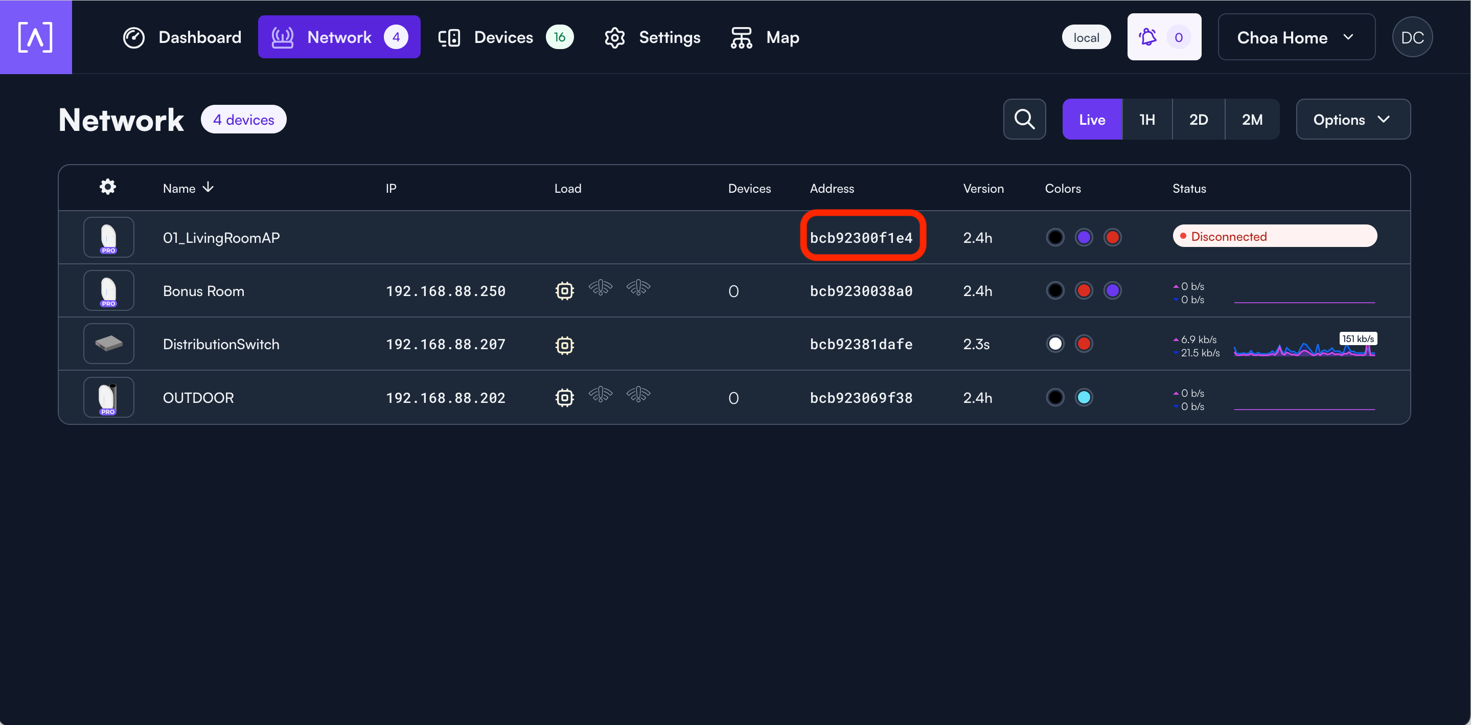

I’m having a bit of a struggle here with my local controller.

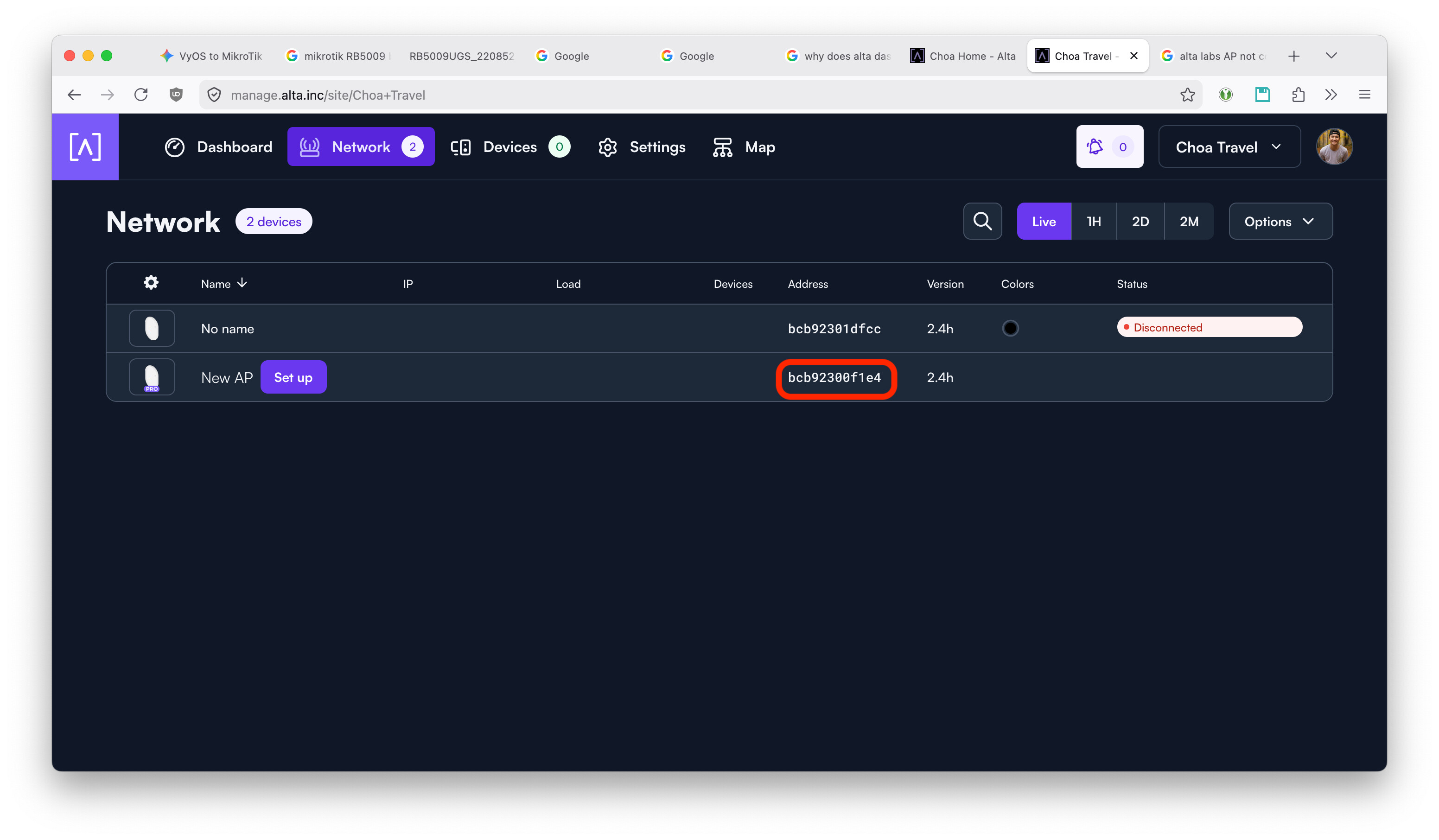

My primary AP6-Pro is showing up as ‘Disconnected’ in my local controller, but it shows available for setup on the Alta Cloud Controller. I can’t SSH into the AP for whatever reason, but it is serving its previous config just fine and everything is working I just can’t manage it at all. All of my other Alta devices reconnected to me local controller just fine.
What is going on?
