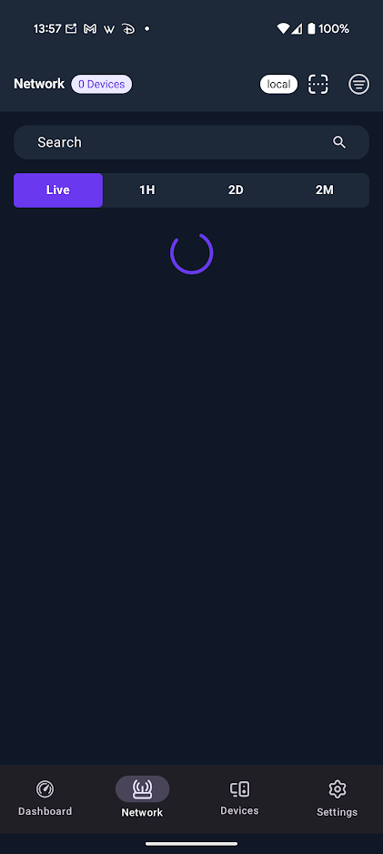

I have a local controller setup, and when connecting to it via the Android App, it connects, however the app shows almost no information, and I cannot actually control anything in the App. I’m using the controller behind an Nginx proxy using custom DNS.
The app logs in, but when I try to view any of the pages in the app, it just spins. Nginx logs from the proxy are showing several requests that should have been properly served based on the log entries, as they all show 200s.

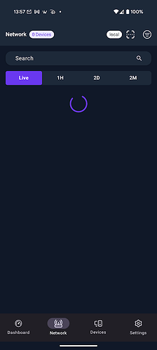

Here’s the screenshot:
Adding via ddns hostname works, however that won’t accomplish me being able to manage this remotely since I have several things running on this network that are public facing on 80/443.
Yes, fully understood. I just wanted to make sure that the service behind the proxy was functioning as expected so we’re not trying to troubleshoot a symptom rather than the root problem. I’ll see if I can reproduce this and get back to you.
