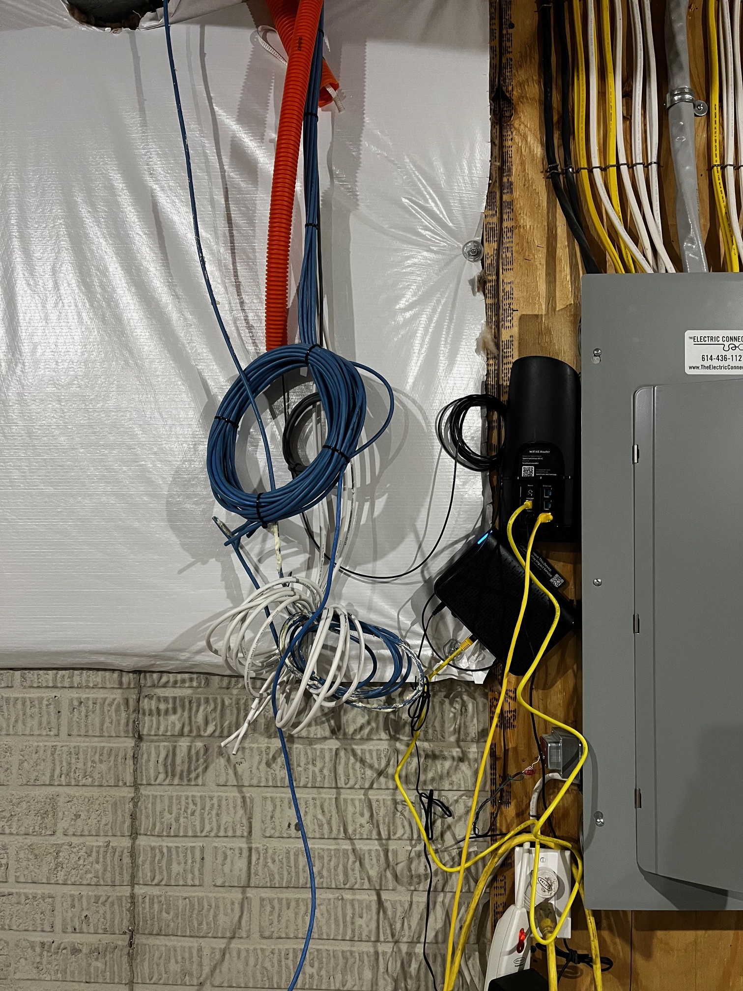

Moved into a new home. 2,800 sq ft. split evenly between finished basement and upstairs. Wood frame construction. Home has Cat 6a ethernet terminated to every room via wallplates. In opposite corners of the house on the first floor in the ceiling there are ceiling boxes that have Cat6a terminated in them. I was told this is for access points. I have a Spectrum modem that is a fiber termination point. The spectrum device is also a router. Only half of the basement is finished. Mounting an access point in the basement will be easy if needed.

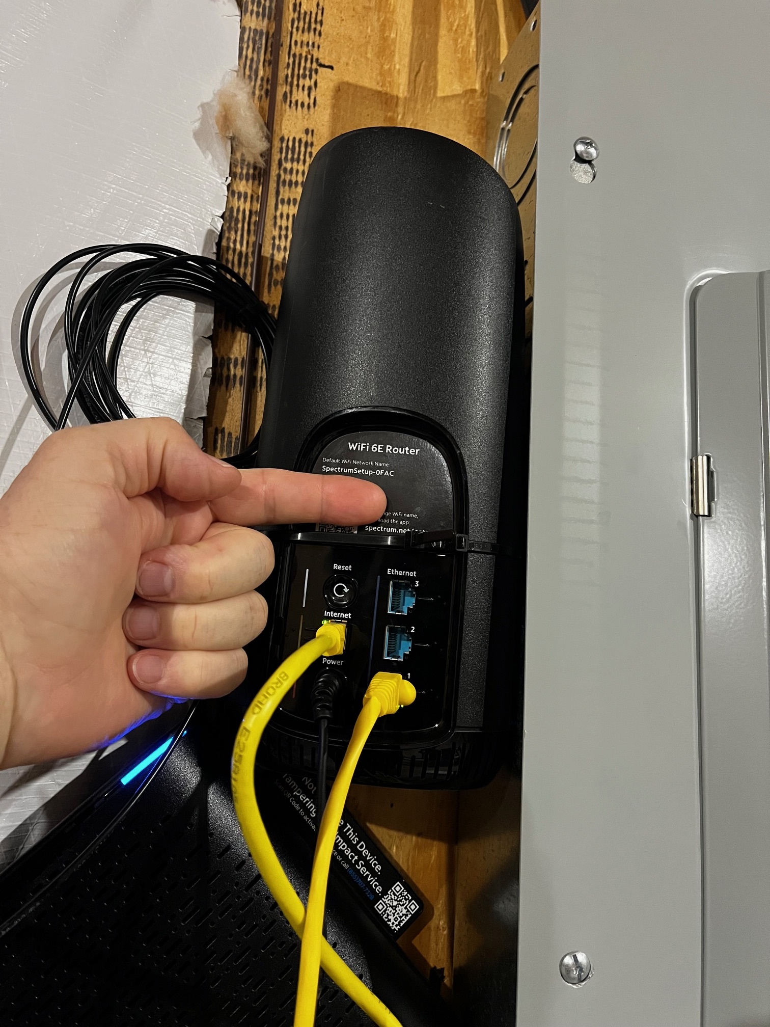

First and foremost, this plan is dead in the water unless you ditch the spectrum provided ONU/WIFI combo device. You can easily reach back out to spectrum and request a “Modem Only” device (Model: Spectrum SONU, if you’re in an EPON segment of their network) This device simply handles the OE conversion and hands off your level of service over copper ethernet, whether it be 1G, 2.5G, 5G, 10G.

  • Do all the Cat6a throughout the house meet at a centralized location? Basement? Utility closet? Garage? Egress out the side of the house? (Yes, I’ve seen this). If indoors, are there any electrical outlets in proximity to where the wiring is?

  • All Cat6a terminates in the basement at the same place next to the electrical service panel. All cables are marked. Electrician will be installing a 20 amp 4 outlet gang box at the termination point.

Easy-peasy. You’re already in a good place.
The SONU model I mentioned is right below the Router/AP unit with the blue led. That is your fiber ONU. The OE conversion is being done before the Router/AP unit, but backend protocols such as TR069 are usually in place which require the devices to be unmanaged by spectrum or you’ll be alerted until the end of time. Additionally, just removing the combo could affect any cable boxes or spectrum provided IPTV services that rely on communications deriving from that specific Router/WIFI unit. This shouldn’t apply to you since there was no indication of utilizing them for streaming IPTV.
Once you’ve decided on gear, you can give spectrum a call and confirm that you’ll be utilizing your own router and WIFI device at which they will modify your account accordingly and ask you to the return the device. The reason for the coax inquiry was to determine if you did and if so, where to, as these wires “while originally intended for traditional communications to cable plants/networks,” can also be utilized for LAN communications within the home through means such as MoCA. I’ve verified and tested MoCA through the Alta stack and confirmed it’s functionality for transporting ethernet point to point.
