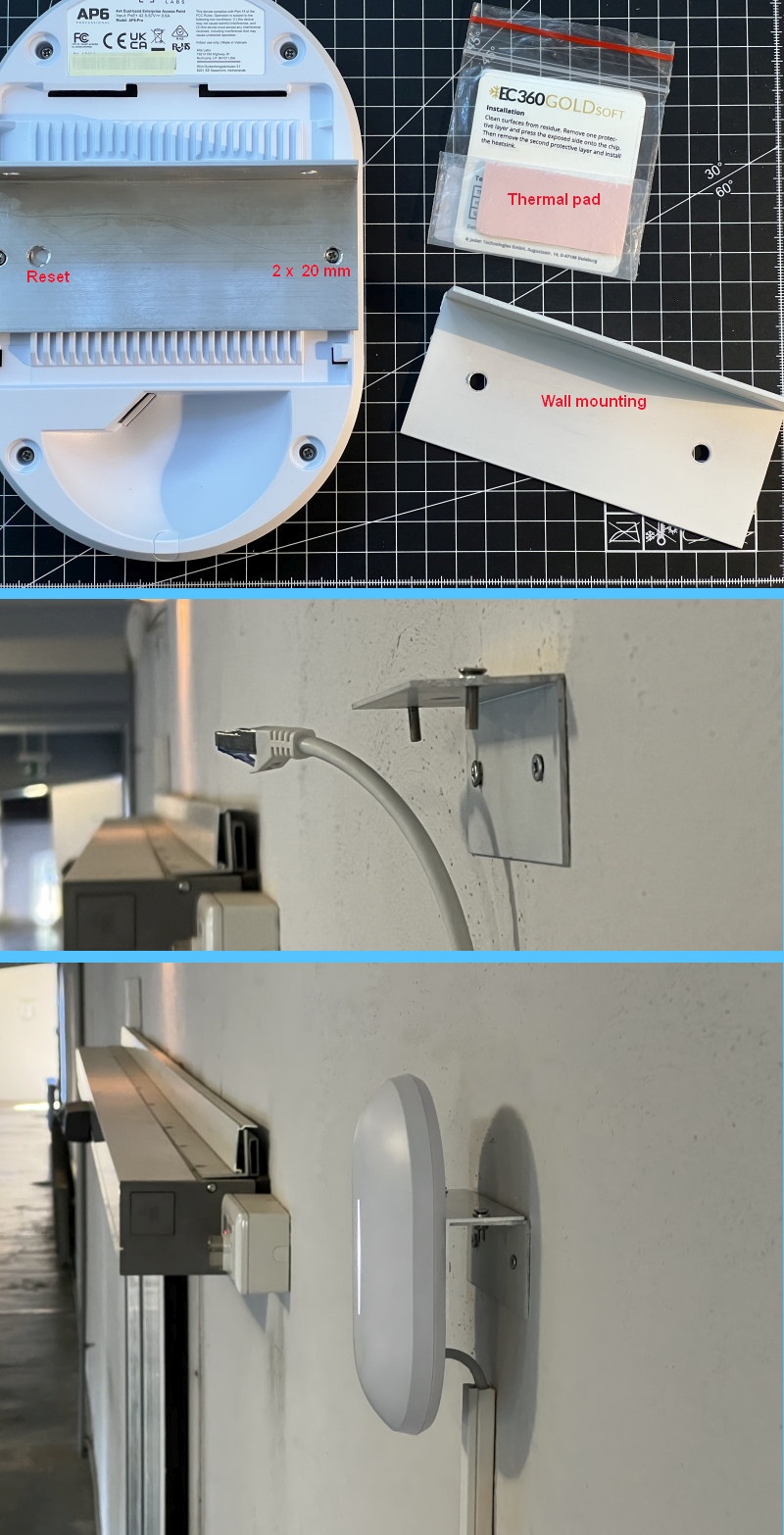

I wanted to improve the situation and mounted the AP on an aluminum rail. The air gap was filled by a thermal pad.
This is unnecessary in a cool environment. Screw replacement is not covered under warranty.
However, I was able to reduce temperature peaks this way.
Before:
root@unifi:~# ssh root@172.27.1.242 -t "cat /sys/class/thermal/thermal_zone*/temp"
67000
72000
68000
75000
After:
57000
60000
56000
62000
These values were obtained after 6 hours of streaming with 20 to 30 clients.
