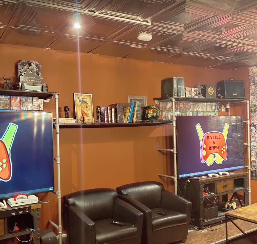

Here’s some photos I can share out. It’s still an ongoing process but as you know in IT, sometimes you just gotta get it done and “one day” come back to clean it up.
