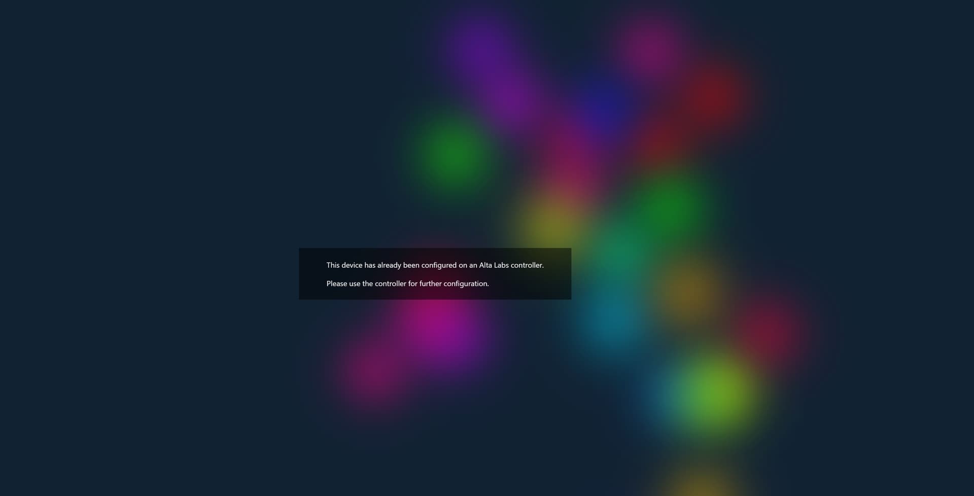

I have Windows Server 2025 and iis site, I can browse to my site using hosts file, the domain points to correct address, and I configured ddns using dynu provider.
When I try to reach my site I get
Inspecting network tools i see this
I use cloud controller ( got dedicated controller but not installed yet)
I have switch 8 ports, AP 6 pro and route 10. Route10 connected to my ISP using bridge mode
I am not sure what to do, I tried to add filter but still getting the same problem. I am not a network expert so please bare with me :slight_smile:
What do I need to do?
