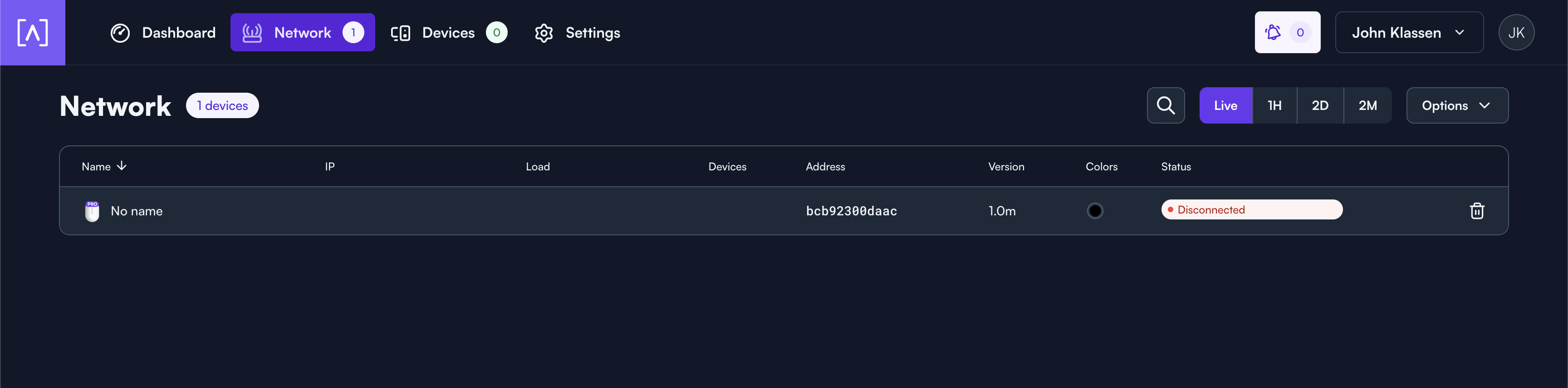

I’m having an issue where after I click Setup (whether it’s on the web or app) the A6 Pro shows disconnected indefinitely. No VPN’s or VLAN’s are used in my network. Factory reset doesn’t seem to fix the issue either. The AP shows a firmware of 1.0m.

I think I just figured it out. I run an ISP so I have the ability to change my public IP address at will and it seems like my newer IP block was getting blocked, once I set my home to a different IP from an older Public block the cloud was able to see my device. Would it be possible to see if my IP was actually blocked?
