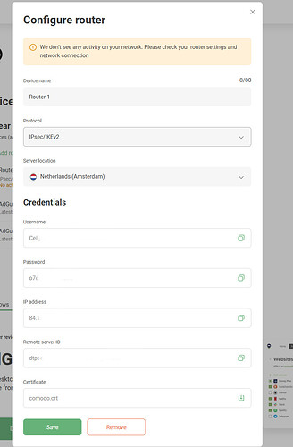

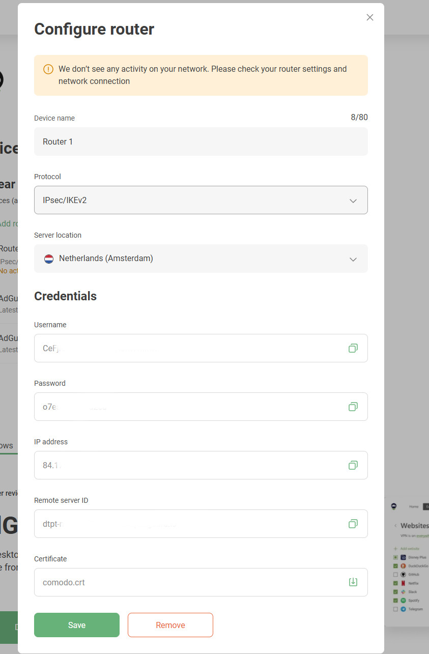

In the age of widespread surveillance and restrictions, I wanted to use the VPN client option. I have AdGuard VPN. Has anyone already tried to run it on the Route10? In AdGuard’s options, there is the possibility to configure it on a router via IPsec/IKEv2 . Now the question is: how do I upload the certificate to the Route10? Has anyone tried to get this working? I’d be grateful for any information.

Thank you for the tip. Today I had more time and dedicated it to thoroughly checking, but unfortunately there’s no activity on the AdGuard server. To be honest, I’m not even sure if it’s working at all from the router’s side :confused:
