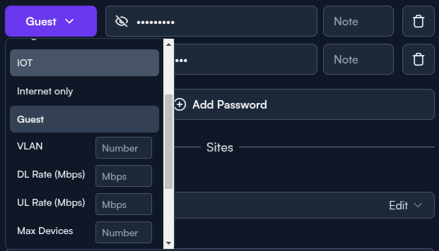

This may not be exactly what you’re asking for, but one option is to set limits on the SSID.
Hi Josh, I have the the limits set to 10mb/s for guest access, but if a large volume of people connected at the same time they could still over whelm the bandwidth . so being able to provide QOS to the main SSID would be a nice to have.
