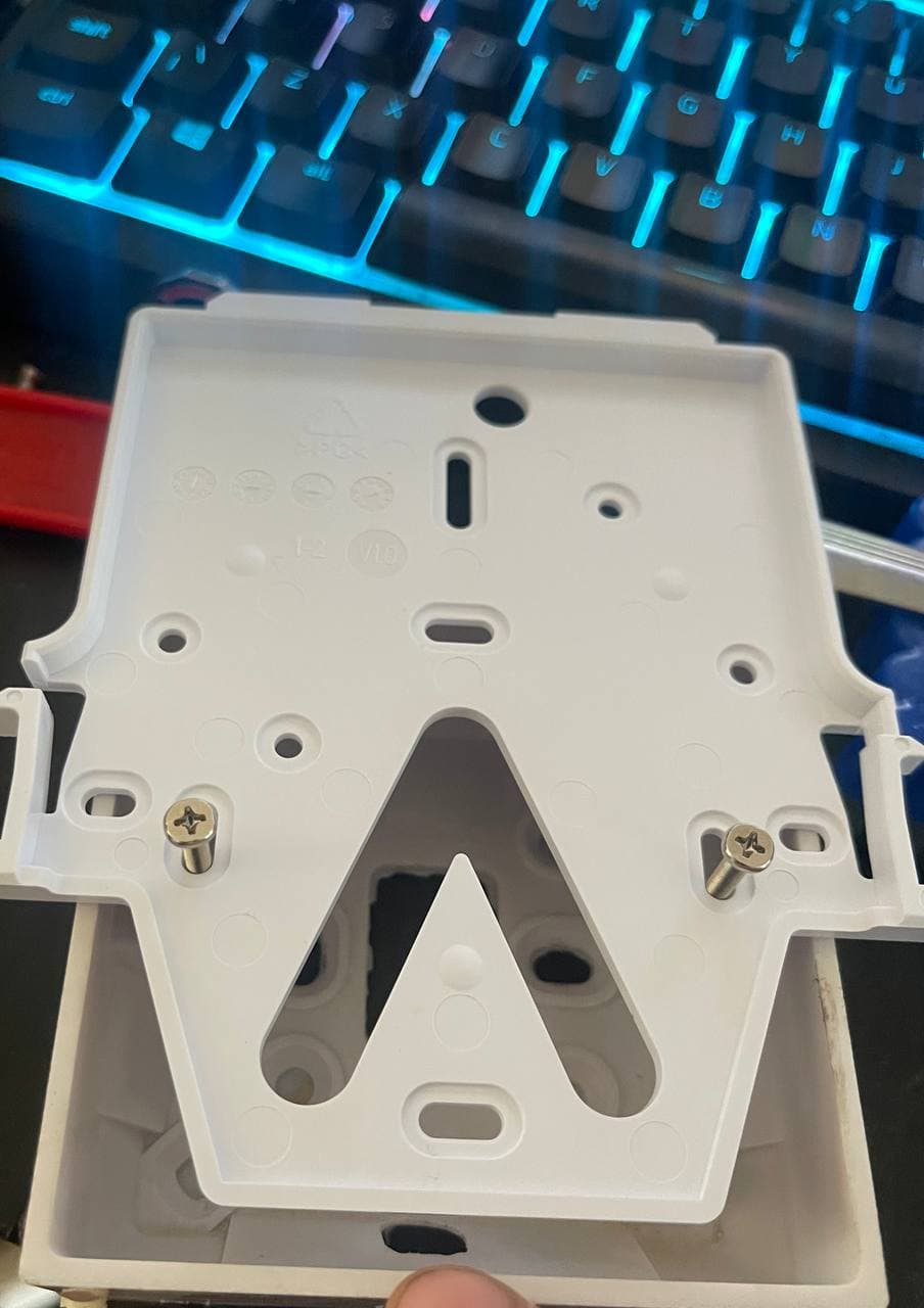

mounting bracketon one of my back boxes seems like im unable to properly secure this device on to my back box here in the uk seems like it was going to slide off and is able too

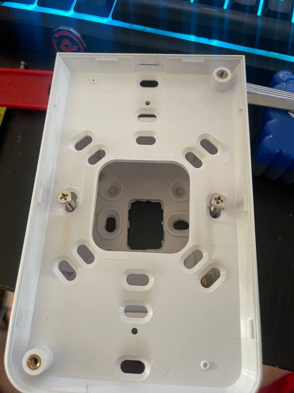

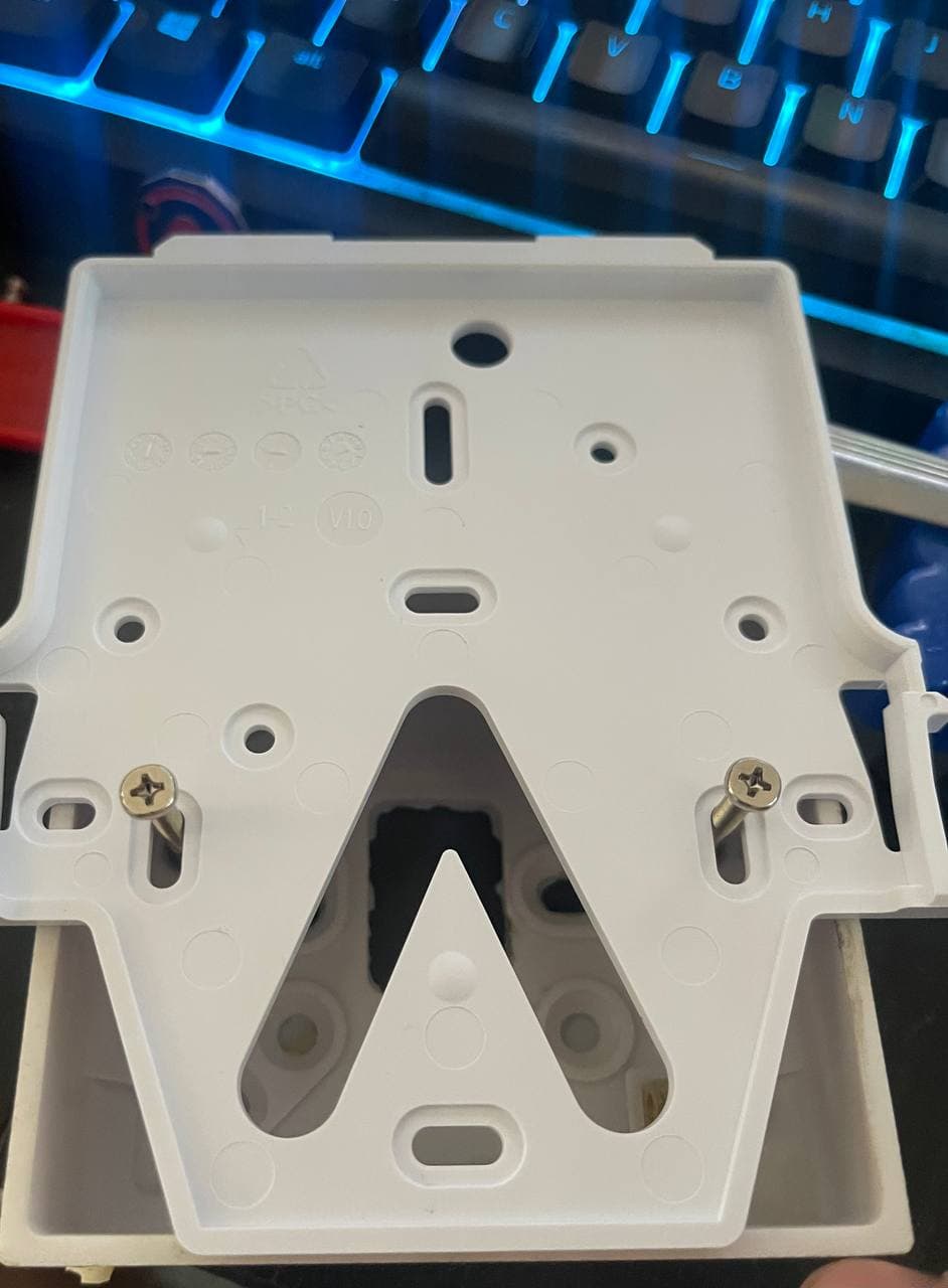

heres the pictures to show this this was not mounted properly as was not screwed down fully

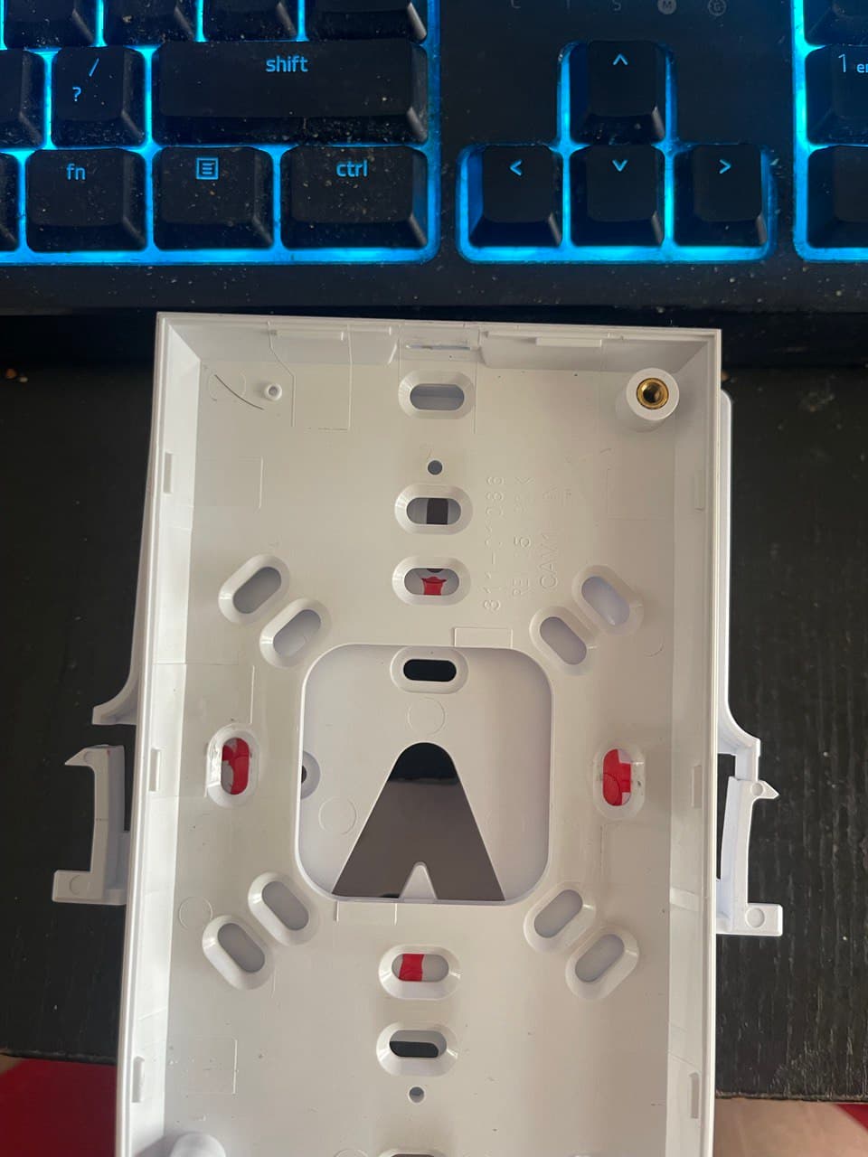

ap6 position is not correctly right on this mount the holes used needs to be a little bit higher
will slide bend in

the points are in the right place but needs to be moved up a little bit as its not going to sit flush tightening the mount to back box also bends it too i like a tight fit

@regchan Thanks for bringing this to our attention. Just to clarify, I see the bottom of our bracket resting on the box when the screws are resting against the top part of the radius/hole.
Alta Forum
Is that not sufficient enough support? We still need to extend these openings a bit? If so, how much further down would you like to see that bracket on this mount?

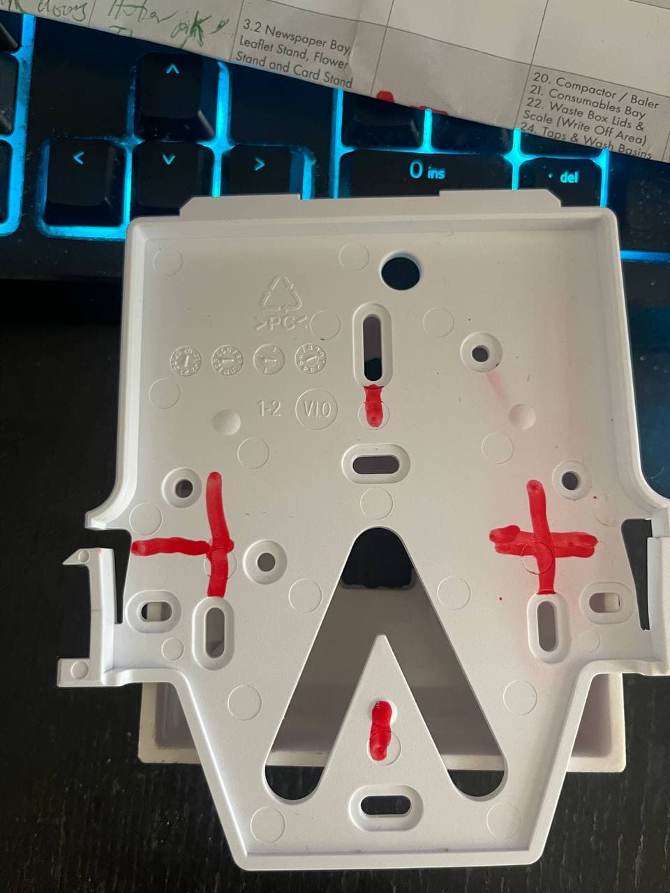

hope this helps ive drawn over my bracket roughly the exact spot i require it to be might as well extend the top down further the red is to be added the cross was as best as i can get it just raise it to the cross to be a good fit
