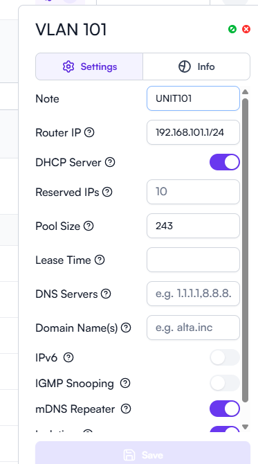

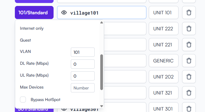

I am using password dependent connection for WIFI so i can have multiple passwords and this is the setup, please see below.. Does anyone have any suggestions?

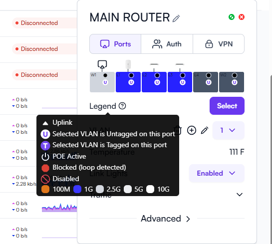

ETH2 (LAN1) is showing 1GB link

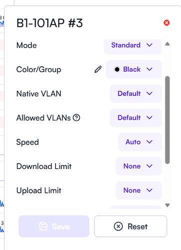

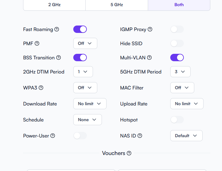

Also, on the wifi setting page on the bottom, no speedlimit is set

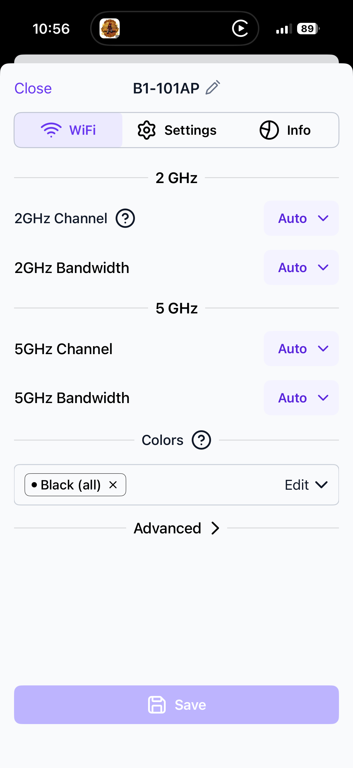

What AP and what channel width selections on 2,4 and 5ghz?

Alta AP6 AP
