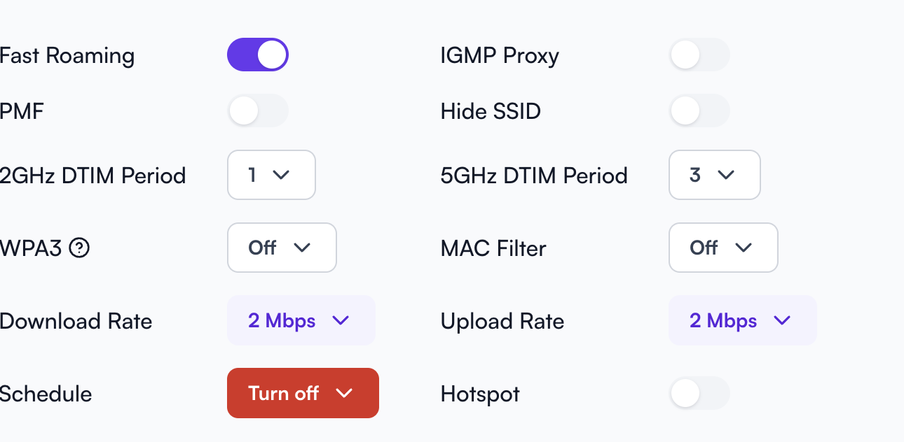

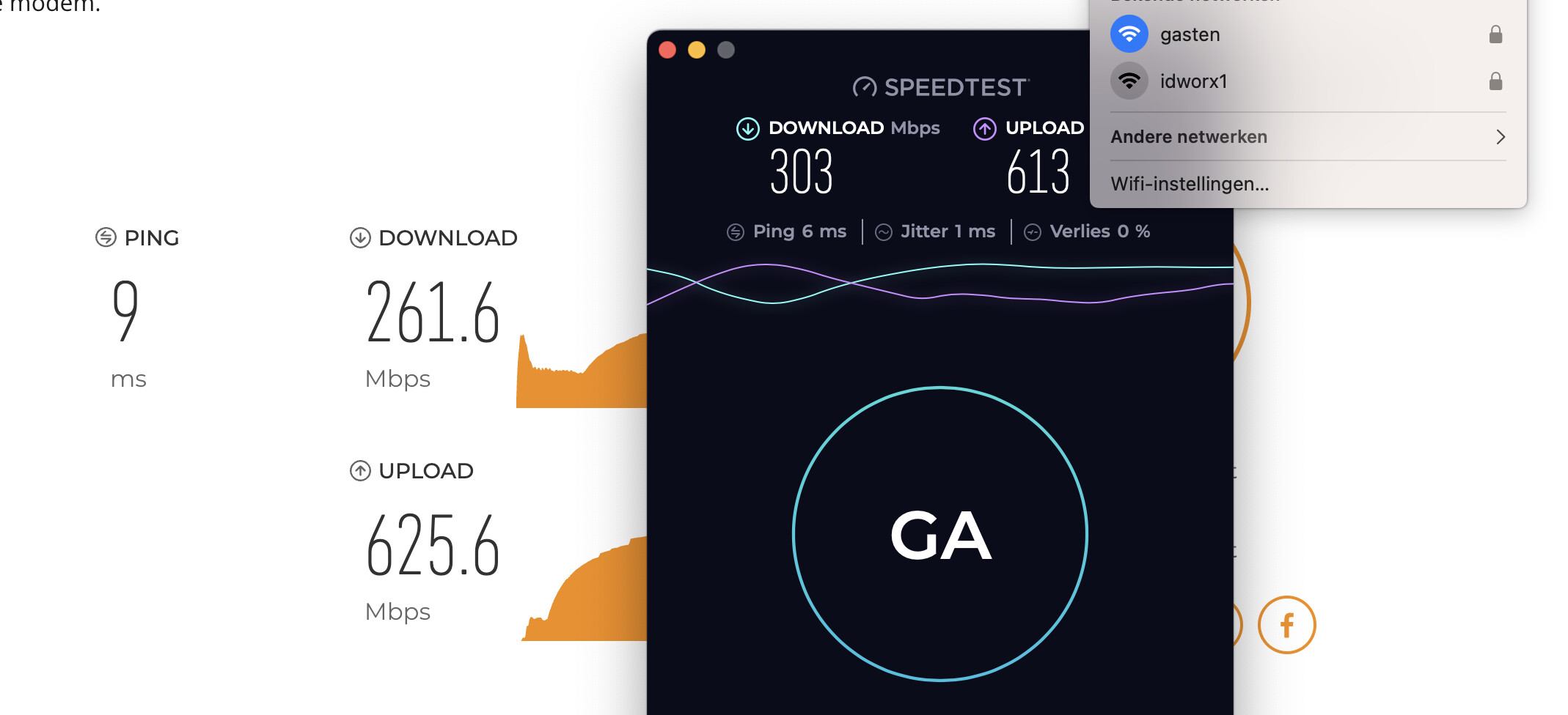

I found a bug in 1.1.H firmware: I made a seperate guest SSID (Gasten) and made a speed limit for up and down for 2Mbps
But my guest gets a little more speed.
@Mollie We aren’t able to reproduce the issue here, so can you invite me to your site and let me know when you’ve reproduced the issue so I can grab the AP logs? Otherwise, if you can ssh and scp the /var/log/messages* files, that would be helpful. I’ll send you a chat message.
