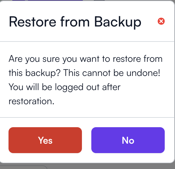

I have the Controller running in a Docker container on Kubernetes using the most recent container version (altalabs/control:1.1n-amd64). I have tried to restore a backup from both 1.1n and also have updated to the latest within the controller (1.1t) without success.
There are no error messages, just the dialogue does nothing after clicking yes:
I’ve tried this on both Vivaldi and Safari with no luck. I’ve also tried a few older backups to with no joy.

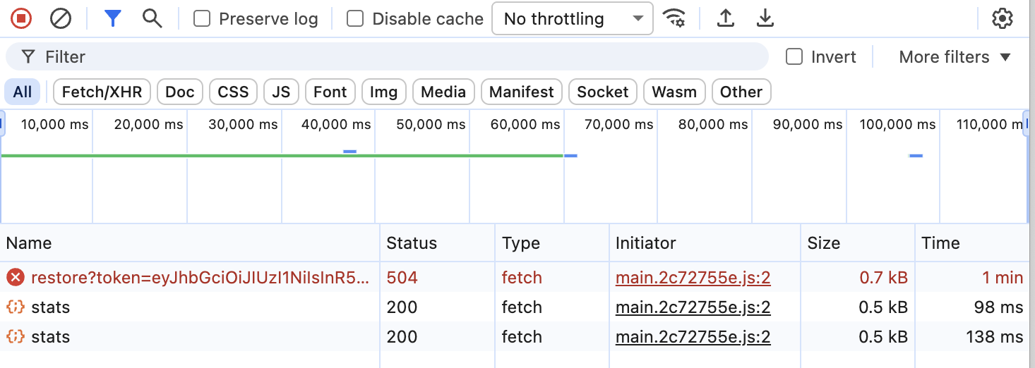

The output from Vivaldi’s network tools isn’t helpful either:
Does anyone know how I can restore from backup as I don’t want to have to manually recreate my network.
This has happened on more than one occasion with the Alta Control. I’ll let them answer to that.
Please make sure you are on 1.1t, and then attempt to restore. If you still have issues with that, I will need your backup file to try it here and debug the issue. I’ll DM you for that, if it’s necessary.
