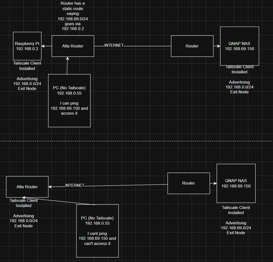

I tried to get this scenario to work and use it to access a remote tailscale enabled/router subnet.
Im at home with 192.168.42.0/24
would like to access 192.168.33.0/24
I added a static route to point the .33 subnet to be accessible via .42.1 (i.e my network) and no go. Without the static route no go either.
Not sure how I’ll get it to work but that’s how I had it setup when my raspi was by subnet router and had a static route on my router pointing at the raspi for that subnet.
Yes I appreciate a raspi is not a fw router.

@S_NZ Can you provide additional detail on your setup? A network diagram would be helpful to understand the pieces. In my own setup, when using the advertise subnets config on route 10 I can reach those subnets without additional static routes.
Here you go. First up is how I’m doing it now and second is what I tried to evolve it to!
If performance isn’t great I guess a 3rd Nirvana (for performance) would be if I can just have a Alta Router at both sites and sling a better performing VPN between them (probably fully route both subnets, but I should limit for security)
