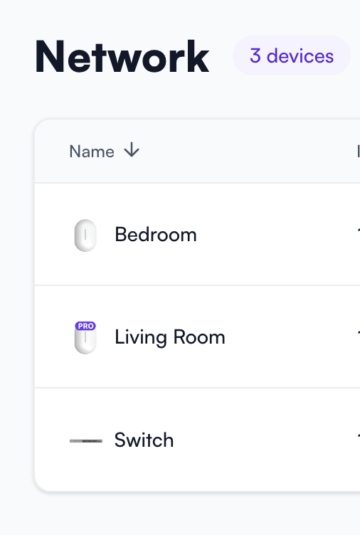

Hi Matt, there might have been some miscommunication there. It is all correct on manage.alta.inc. I was saying it is not correct in the iOS app. Did you still want a screenshot of that?
