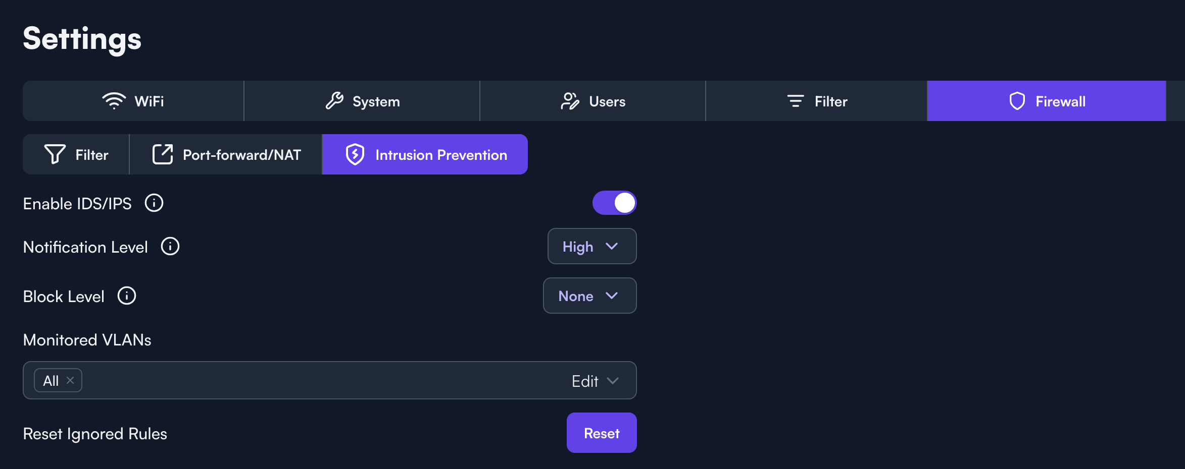

There is also still the IDS/IPS setting to check. It shouldn’t impact this, but we should confirm it just in case.
IDS/IPS doesn’t affect speed. However, I’ve noticed that when I see 0°C on Route10 in the control panel, the speed drops to 200MB/s. Like Now
