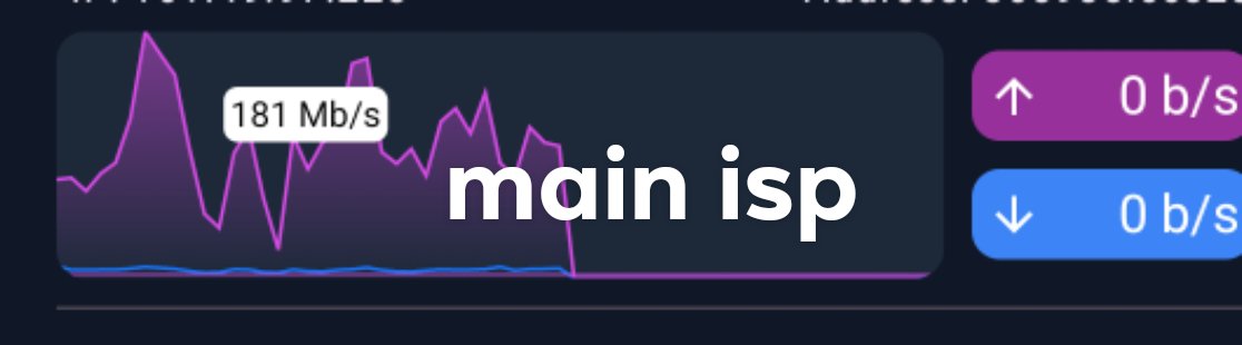

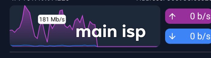

i just bought my route10 and try it.. all are good except the loadbalancing..its like all my traffic only go in my main isp while my second isp is just like in standby mode.. the metric equal but still nothing happen i change the metric of the second isp to 2 and return it to 1…traffic goes on but kind of low its like 95% to main isp and 5% to 2nd isp.. then comeback to like standby mode again

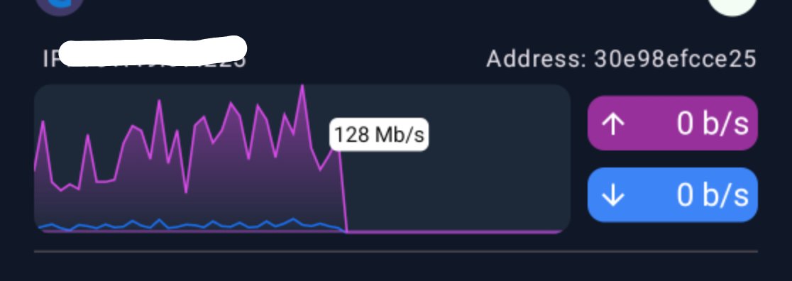

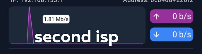

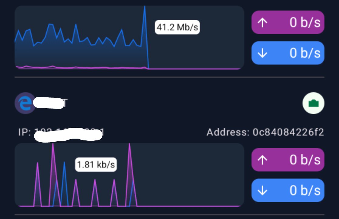

these is my setup as you can see main isp almost have all the load while 2nd isp almost dont have load..which is on same metric my main isp has 800mbps while 2nd have 300mbps.. it should be atlist get some traffic to balance..
