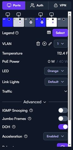

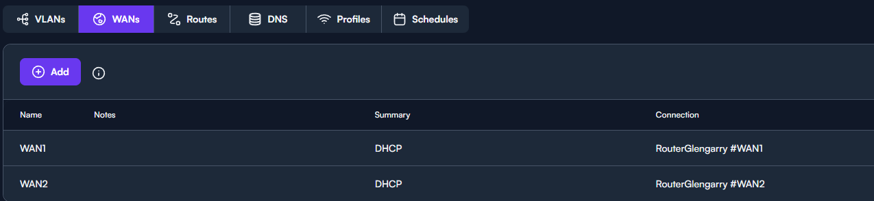

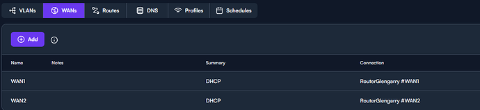

WAN setup looks like this (WAN1 active currently)
Firewall Rules are Vanilla, No IPS/IDS at this stage.

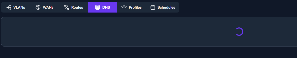

When I click DNS, it just spins as above but if those settings aren’t of consequence, then no worries.

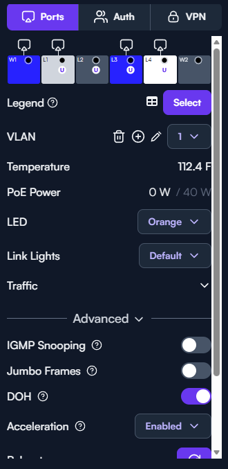

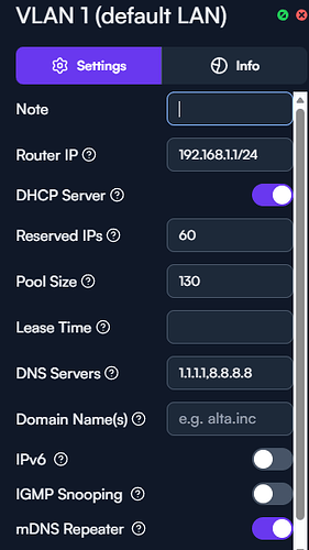

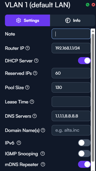

Further settings for reference
