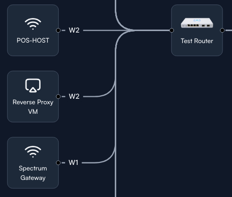

Thanks for the update @Alta-MikeD ! A quick note on the map; appreciate it that it now shows WAN side devices on the left, although on one site I have WAN2 configured as a LAN port and the map is showing those devices to the left of the Route10 as well:
Hopefully it would be possible for the map to detect if WAN2 is in standard or WAN mode in a future update. Thanks!

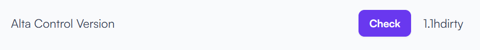

After updating, it shows the version as “1.1hdirty”. I’m guessing that isn’t good?
Seaching around the forum I spotted a couple of references to “dirty” being used for development versions of firmware. If it seems to be working and running properly, I’d guess that tag didn’t get removed before the firmware was released. Or maybe the last development version was accidentally released instead of the “final” version. I suspect @Alta-Jeff might be able to shed some light on that further :slight_smile:

We’ll take a look at this and base the side on the configuration in the next release.
Full explanation: “Dirty” typically means that the code-base was not in pristine shape when the package was released. In this case, it was code checked into the repository that actually changed the checked out code during the build, and we did miss that, but we will correct this in an upcoming release.

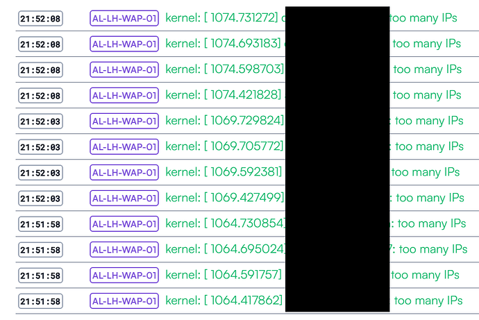

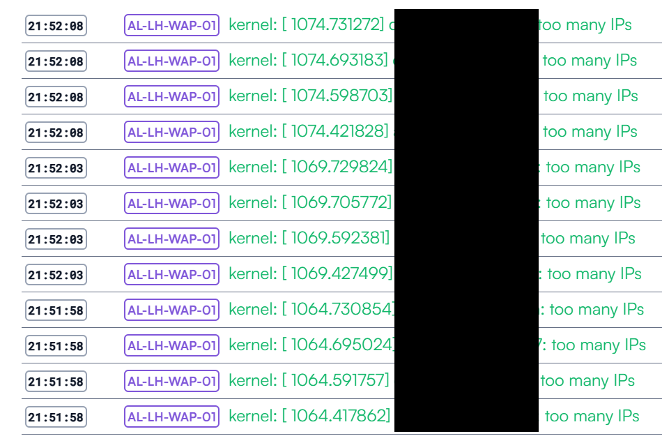

The APs will track IP addresses of each station associated, and in this case, you have a single station that is using more than 5 IP address. This is definitely a corner-case, but it just means that the AP isn’t tracking more than the original 5 it saw.

Reach out to support and they will be happy to help you downgrade. The IP address tracking feature you reference above has been in the AP firmware since the beginning, however. We are definitely curious what WiFi device you have that claims over 5 IP addresses to see if there is something we are missing…
It’s not one device.
We aren’t seeing anything like that anywhere - from what we can see, those devices are using several different IP addresses over the course of a short period of time which is indicative of a larger problem. Please invite me if you want me to take a look.

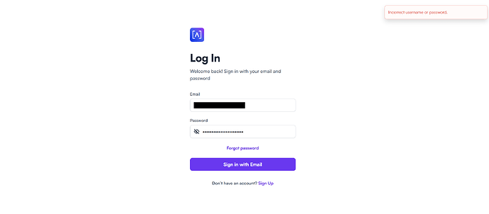

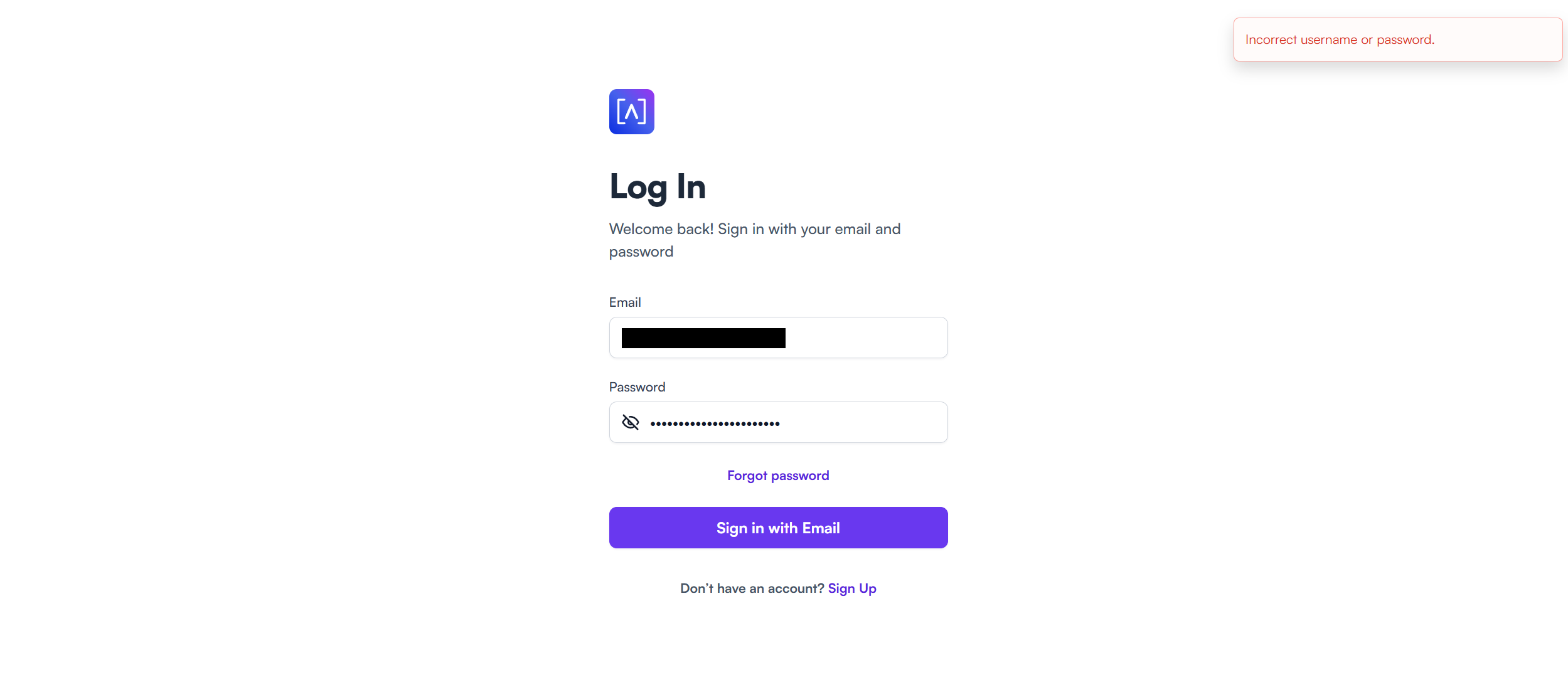

Lost access to Control yet again. This is the second time this has happened.
My account is gone on the control but I have SSH access. I’m not going through another eco-system reboot.
When you change the allowed ports under settings, save and then remove it, it wipes your user account. This is a serious bug for local control users.
I assure you it’s not wiping any user accounts. I can guide you through connecting to the postgres database via ssh if you want to confirm.
However, you are very likely misconfiguring your controller by changing the allowed ports to something that does not match the environment you are connecting with. This is certainly an advanced topic, and I’m happy to take a look at your specific installation to see what ports should and shouldn’t be configured.
