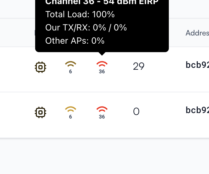

I have got the 2 accespoint back. i experience that no devices will connect at 5ghz and the load is read and says 100% load. But with no devices connected?
Scherm­afbeelding 2023-08-11 om 15.45.55
Got it solved. But needed to remake the site again. Power cycle did not help. Tryed to change channels manual but system would not accept. So deleted site en and did a rebuild that solved that.

Regarding the Netgear, I am curious if we exhausting its PoE budget? I can see that based on power supply you are using with it, the budget increases or decreases. With the radios being solid red in the dashboard, we have only seen that when an AP is not receiving adequate power to completely boot.
