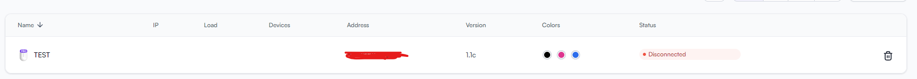

as a part of a presentation I removed the AP from the site to show how easy it was to on board the AP, but after I pressed the “set up” it came on as “disconnected” and has stayed like that since (around 24 or so hours)
anyone know what I should do? I have tried to reset the AP and unplug and plug the PoE in

it should be mentioned that before the set up has been pressed its not visible on the web int so i have to set it up via the mobile app (no biggy ALTA has made really straight forward) but then it disappears from the list on the app and then its visible on the web int only…?? I’ve made sure that both the laptop and mobile is on the same network as the AP6
