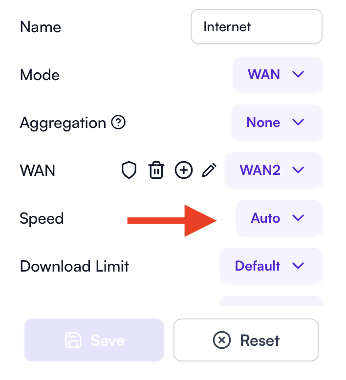

Hi , you may check on the WAN port that the “Speed” setup is on “Auto”. By default is on “Default” which could limit the bandwidth
Thanks. It was set on 10Gbps so I tried Auto. No change. I have also tried to adjust the download and upload limits to the varying options with no change. I have tried the CAKE and Bufferbloat settings as well but alas no change.

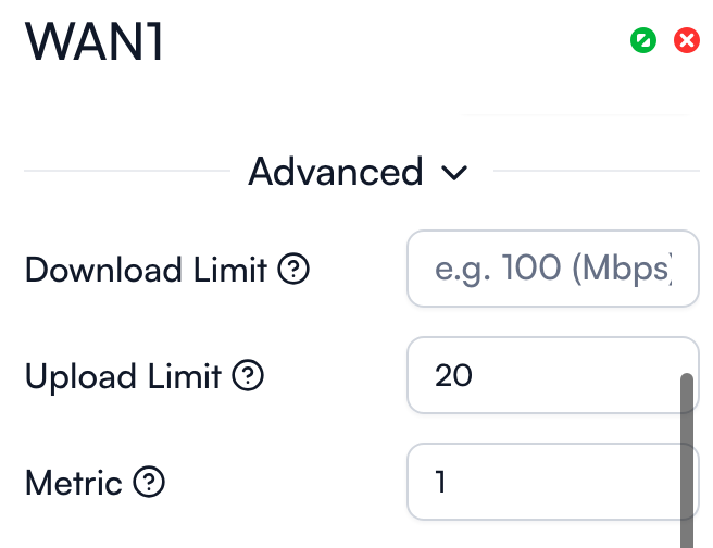

If I’m reading his post right, it sounds like @Alta-James is talking about these settings:
@jmszuch is correct. I removed the traffic shaping on the WAN connection profile. With such high WAN speeds, it looks like it was doing more harm than good.
